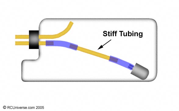

Also, I suggest that you put a short piece of solid tubing in the pickup line to assure the clunk can not flip forward. Ken will be showing a picture of this in his thread soon if you are unsure of what I mean.
You can't work the battery or RX under the fuel floor through the bulkhead behind it?
Don't know what you mean by 'short piece of solid tubing in the pickup line . . . ' Can you show a detailed view of what you mean?

Default RE: MY KADET LT-40 BUILD
See diagram
Ken
Tigerdude,
I do all of my fuel tanks like that. If you do it this way you won't have to worry about the clunk getting stuck in the front of the tank.
Ken
