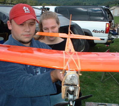

Just use some rocks that are taped together
