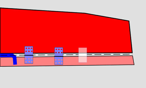

The picture is what I think you're saying you have now. The wing and the aileron are obvious. And the dark blue right angle to the left represents the torque rod. And there are a couple of nylon hinges and a CA hinge. And obviously there is a large aileron gap (with a dotted line down it's center.
When you attach the torque rod to an aileron (or elevators or rudder) you inset it into the aileron. (I think you've already learned that JUST NOW. right) The amount you inset it would be half the thickness of the torque rod. You want the axis of the rod to line up with the "hinge line axis". With the nylon hinges that look like door hinges, you have to cut slots for them and ALSO inset them slightly into the aileron so that their very centerline winds up where the center of the wing:aileron gap winds up after you connect glue the ailerons into the wing and the aileron. That means with those nylon hinges you have to also slightly inset them into the wing as well. With CA hinges, you don't inset them, you just cut slots for them and try to get the aileron as close to the wing as possible, to have the least gap possible, and glue them.
I said all that and drew the picture to illustrate the problem. The problem is to wind up with the torque rod and whatever hinges you install, both to have the same axis or rotation and that axis winding up being the almost invisible line where the aileron LE touches the wing TE.
In the picture, if you look closely, I drew the torque rod having an axis that's centered down the huge aileron gap. I also drew a nylon hinge that was on that same axis. And I drew one that is placed like you would place it to be on a zero-gap hinge line IF the torque rod had been inset. And there is also a CA hinge represented.
If your torque rod is placed like in the picture, you have a problem or two. You need to inlet it into the back of the wing for one thing. How much?
Ideally, the axis of all the hinges are all on a straight line and the torque rod would be on that line too. If you do as you say you plan (and it's a good idea but one that needs some more planning) and glue in a filler, the filler ideally would only fill the gap from the aileron LE to a line that'd run through the torque rod's axis. See where I'm going? or would you like more????????
Anytime you have a number of different type hinges, you have to place all of them so their axis line up or they will bind the free movement of the surface. The stronger the hinge, the worse the binding. CA hinges don't care where they bend so will be forced by a strong "hinge" like a torque rod to try to bend inside the wing. Not good.

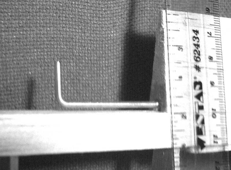

I thought I'd post a picture so you could better see the problem. A bit out of focus, but you can see by the ruler (divisions are in 1/8ths) that the rod sits about 1/8" off the wing. 1/16" balsa sheeting slides nicely under the torque rod.
Any new thoughts?
I did cut out a groove in the aileron so that the center of the torque rod is in line with the 'leading edge' of the aileron.

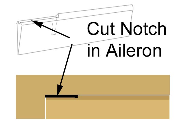

There is an easier fix for this. Right now you have the groove in the aileron cut so that the torque rod is flush with the top of the forward edge of the aileron. Cut the groove a little bit deeper in the aileron so that the edge of the aileron is against the trailing edge of the wing, and so the torque rod now sits a little deeper than the edge of the aileron.
Ken

Really, either fix will work, but Darock's is a more proper way to do it as it will put the torque rod on the hinge line.
Time Pilot, Use the 3/32" sheet you have and do it like you said (Cut a groove, slide it under the torque rod, and glue it to the Trailing edge)
Covering should go UNDER the torque rod, not over it.

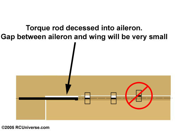

BTW, Ken,
Actually, filling with just one strip of wood would be what you wanted to do if you were using nylon hinges and planned to move their hinging out to line up with the hinging axis already established by the torque rod. If you round the resulting LE of the aileron, and use hinge locations that are online with the torque axis, you wind up with a very elegant result.
I've added a couple of hinges that would work and one that won't:

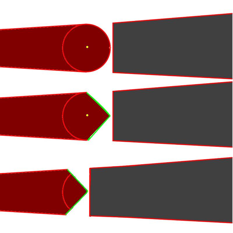

TimePilot,
With the aileron not yet placed, truth is, all you have to do is put in one filler, and that one on the back of the wing. Fill out to the centerline of the torque rod. Then taper the front of your ailerons to come to a point along the centerline of the torque rod and you're ready to hinge. And the hinges and torque rod will all share the same center of rotation.
I've drawn a picture to illustrate the problem with having two centers of rotation. And one to show the setup you'll have by filling half the gap and alingning the aileron to fit that.
The top picture shows what you have now. The little yellow dot is the center of rotation of the torque rod. The gap is where it would be if you had the aileron all the way forward.
The middle picture shows that same little yellow dot. That's where the torque rod is going to rotate. At the point of the green lines is where the aileron LE would go if it lined up to the front of the torque rod. The point on that "arrow" is going to be forced Up and Down by the steel torque rod. If that's where the CA hinges go through, that point on the CA hinges is going to try and rip them apart there. Since the CA hinges are flexible, they're going to shift that tearing force back toward the line where the yellow dot is. If there is balsa wood in the way, it'll just have to crush and bend.
