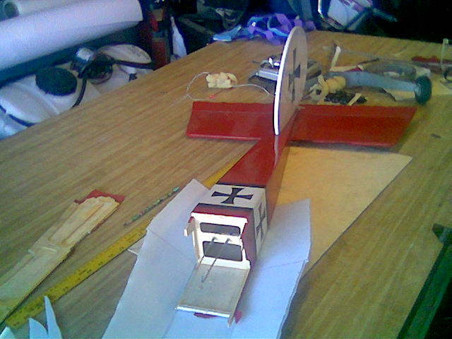

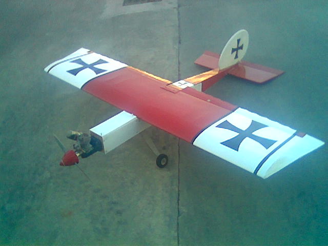

recently crashed my big stick look at before and after pic made front of fuse with coroplast and and making it a tail dragger now how much harder will takeoffs and landing be never flew dragger before

Landing isn't much different. Takeoff is a bit more challenging since it requires that you do a few more things. If you were comfortable taking it off as a trike, the taildragger should present an interesting, but manageable challenge.

The biggest difference is the takeoff, with a tri most just go to full power and zoom down the runway.
With a Taildragger you have to apply the throttle slowly and build up you speed. Why? Thr torque from the engine will induce a ground loop, you have to have a decent speed built up before the rudder can hold the plane in place and taxi strait. Landings are easy with a dragger.

I would taxi the 1st tank out and get used to how it feels. Once your comfortable with it on the ground you should be ok.
