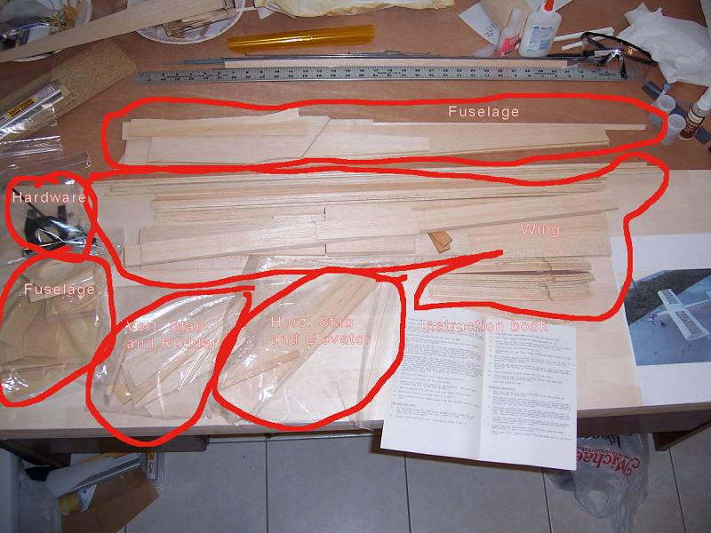

First, a description of the kit. This is an original Joe Bridi kit that I purchased on clearance from the LHS. It is designed to be a trainer and sport flyer with a semi-symmetrical airfoil. It looks to me that with an instructor and buddy box, someone could learn to fly the plane as a trainer but the plane could also be a good second plane. In other words, the eventual recipient may get a first and second plane in one package! The plans and instructions are a little yellow from age but still very useable. The plans refer to using a Kraft receiver and Kraft servos. The wood looks to be excellent. Specs:
Wing span: 61 3/4"
Wing area: 720 sq. in.
Length: 51"
Weight (approx.): 5 1/2 lb. (the .60 engine should really pull this plane around!)
There is a lot of stick cutting to be done on this kit so I will really have to follow Ken's advice about measuring twice and cutting once. This is definitely a very different style of building from the laser cut kits I have made in the past. I plan on taking my time to make sure that this is a solid build. The wings look very solid with 2 1/2" dihedral, partial wing sheeting, shear webs, and cap strips on the ribs. The kit has an addendum that says that shorter ailerons should be made if larger engines are used. The original plan shows the ailerons going out the full length of the wing. The addendum has the ailerons being shorter by 2 or 3 inches. I have heard that flutter is caused by the longer ailerons so I will be making shorter ailerons.
I will start the wings first followed by the stabs and finally the fuse. I will be posting pictures of the build as I go along following the general style that Ken has been following in the LT-40 thread but not as much detail. I know how much time Ken has put in to that thread and I am not able to commit quite that much time. I will be using a lot of his suggestions during the build such as using wood glue and taking my time to make sure it is right. I have a digital camera so I will post numerous pictures as I go along. Sometime this week I expect to have the parts sorted, categorized and marked work will commence on the wing. Like Ken, I make sure that family comes first so things do interfere from time to time with building.

And so it begins! I opened and sorted the kits contents and checked them against the inventory in the instruction book. All pieces are present and accounted for except the rear portion of the horizontal stab (about 1/4" x 3" x 24") is missing. I bought the kit at the LHS and they are usually good about fixing this sort of thing so I will pick up another piece of balsa this weekend when I go there for supplies. Some of the measurements in the inventory list are off by 1/8" of an inch or so, some longer and some shorter. I will have to wait and see what the impact of this is. The wing seems to be about half of the wood in the kit. I bagged the pieces that would fit and just laid the wing parts and fuselage parts in separate piles. All small pieces are in baggies. The hardware is pretty minimal and the nose gear is quite rusty so I will be replacing it. The engine mount in the kit appears to be for a .60 size engine so it will probably need to be replaced as well. The main landing gear appears to be 3/32" thick aluminum which I assume to be sufficient for a 5 1/2 lb. plane.

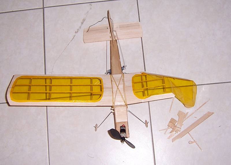

On another note, I had a minor tragedy this morning. My Stevens Aeromodel Lil Squirt got trashed[&o]. I just finished the plane last night and maidened it this morning. I had several nice flights in perfect weather (no wind and temps in the high 60's), got it all trimmed out, ran out two batteries and landed. My friend was flying a GWS Formosa, came in to land, overshot, and smashed into my Lil Squirt. It didn't stand a chance. You can see that one wing is demolished. What you can't see is that the fuselage and tail are also in pretty bad shape. He gave me $25 to buy a new kit so I guess I will be buying one of those at the LHS this weekend too. It would take longer to fix the plane than to just build a new one and it wouldn't fly as well. Weight is very important for a plane this small. The plane weighed just under 3 oz. AUW (I built it a little heavy) and it flew very smooth and slow. Very graceful at less than half throttle and quite perky at 3/4 or full throttle.
Don't worry though, the Aircruiser comes first. It has already taken over my workboard so it will get finished first.
