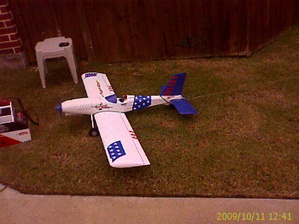

I threw the stock fuel tank away. It's too small that I replaced with a 13oz Dubro tank. I wrapped it with bubble wrap, pushed in the slot, jammed it in place with foams, then install the landing block. This larger volume should make at least 20 minutes of flying at full throttle. My engine is a 46 Evolution 2 stroke with 11x8 prop. It's a pain to install the engine in a tight cut off space. I did not bother to cut the slot bigger. After some struggle, the engine sits in fine.

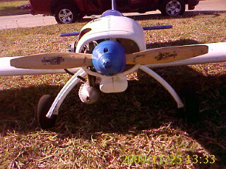

I just wish they do. 51 is my favorite and my shop is full of them, from Topflite, H-9, Kyosho to lesser known Chinese manufacturers. Anyway, I really enjoy the easy fly of this Jupiter, and switch between Jup and Tang so often, when my mood is not so warlike.
Here is my Jupiter undergoing general maintenance

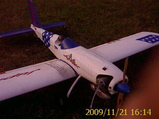

Came back from the field today with the Jupiter. The wind was not so permitting, about 15-16 mph, and the sky was cloudy. Visibility was not that great, but I was able to put in 2 flies. The plane tracked, but was shaken up at this windspeed.
I have to reinforce the landing block. It keeps on popping off. My field is badly rough with tractor's treads, cracked dirt. The landing block does not hold for very long, despite heavily epoxied. There is another thing I did not mentioned in the previous replies. You guys need to connect the rear wheel push rod to the LEFT arm of the servo. The diagram in the manual is INCORRECT, in which it connects to the right arm. If you follow the manual, what you find at the field is the plane will steer to the OPPOSITE direction of where you want it to go.

Tex: On one of the Jupiters I ran into in my travels a fellow was having the same problem with his landing gear block. He had cleaned up the block, roughed it up and reglued it, then screwed screws into it from outside. I've had a couple come loose but it was because I didn't " SCORE " the areas to be glued. On some of them I was pretty rough on them.
The screw cure is pretty drastic but it should work. Just remember that the block is hollow. If you can, clean the area to be glued really good then " SCORE " the areas to be glued. I use a hobby knife and really score/ scratch the heck out of all areas to be glued. If anyone is reading this that plans on assembling a Modelfly plane, I suggest that you SCORE ALL the areas to be glued, it really helps.
I guess if all else fails you might want to try the screw deal. ENJOY !!! RED

Hey Red. Thanks for that tip. I found 2 plastic pins that come with the kit. I drilled hole from the outside and glued them in to hold that landing block. Looking good, just have to see at the field. One of the wheel popped during take off, so I landed with one wheel and nosed over, broke the tip of my blue 11x7 propeller. It is replaced with a wood prop now. There is a little nut that hold the wheel to the strut. This nut should be CA in place before screw the wheel in. I want to paint the prop blue, but afraid the paint adds weigh and shift the prop balance. Any advise?

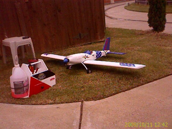

Here are some pics for today. This plane is "like a rock" Chevy. Hard landing, flip over, rough landing are no problem. As you see my broken prop when it hit a bump on full take off speed and flipped over. Absolutely no damage but a broken wood prop!!
http://www.evolutionengines.com/Prod...rodID=EVOE0600

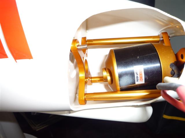

Hi Electricpete,

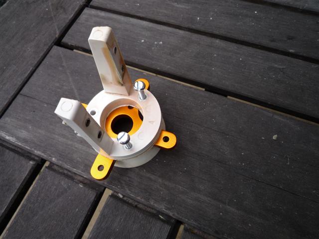

I saw your comment about electifying the Jupiter and thought I'd share with you some work I did on mine. I owned a 'normal' gas powered Jupiter for a couple of seasons and enjoyed flying it a lot but wasn't so keen on the mess from glo-fuel. So I had a long hard look at how to convert it to electric power.
The main problem I came up with is that since the Jupiter is moulded its not as easy as on a wooden contructed model to customise motor mounting or battery placement. For example with the batteries you need to put the batteries into the area behind the motor firewall and can't very easily adjust their location fore and aft.
I managed to get round most of the issues but eventually decided to go back to glo-fuel and never got as far as test flying an electric version. I did manage to
<ul>[*]work out how to fit a motor and motor mount in[*]get the right c of g[*]work out where to put the ESC[/list]and I've posted a few photo's.
To attach the new electric motor mount to the firewall I decided to re-use the original glo motor mount fixing points. What I did was to take the original glo motor mount and cut off the engine mounting arms. This left me with just the circular disc part of the glo motor mount. I then used some new long bolts to bolt through from the glow motor mount, through my electric motor mount and into the original firewall mounting holes. I have attached a photo which shows a 'dry fit' I did of the glo motor mount and the base of the electric motor mount. After testing the fit I then cut the glo motor mount arms off.
For the cog the original glo motor was a pretty heavy item so I used a .60 size electric motor to give me plenty of weight up front
The ESC would then have been situated at the back of the electric motor, in the cowl area to give it plenty of cooling.

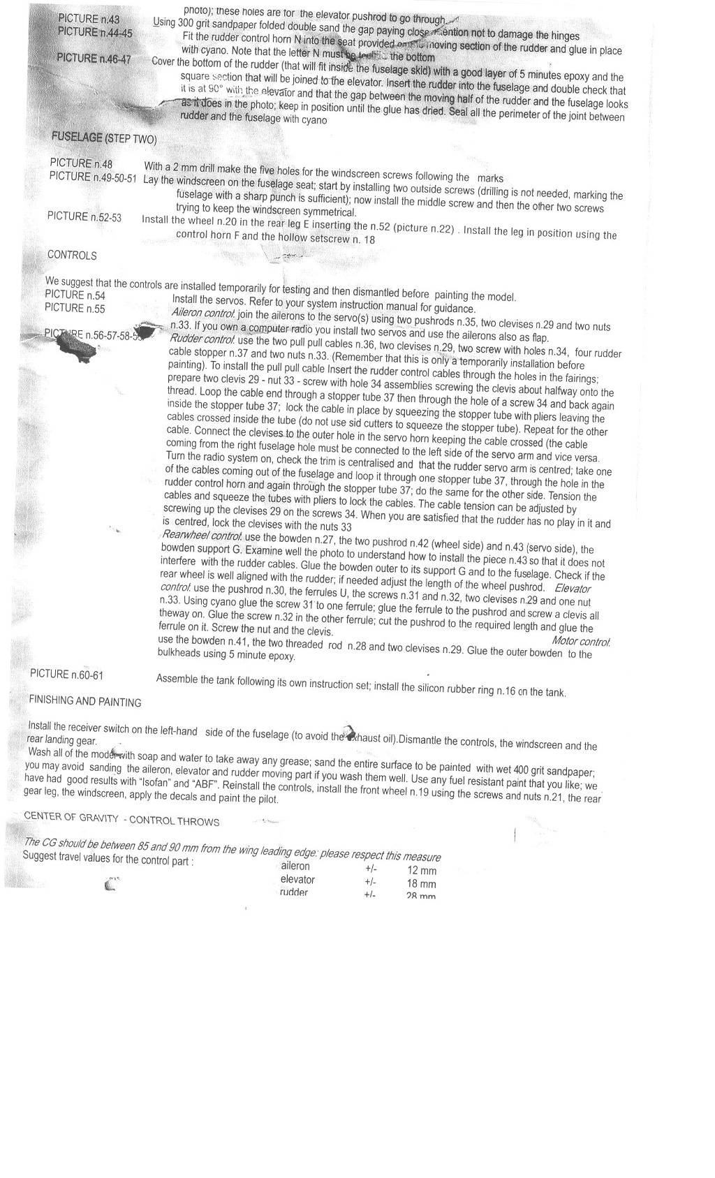

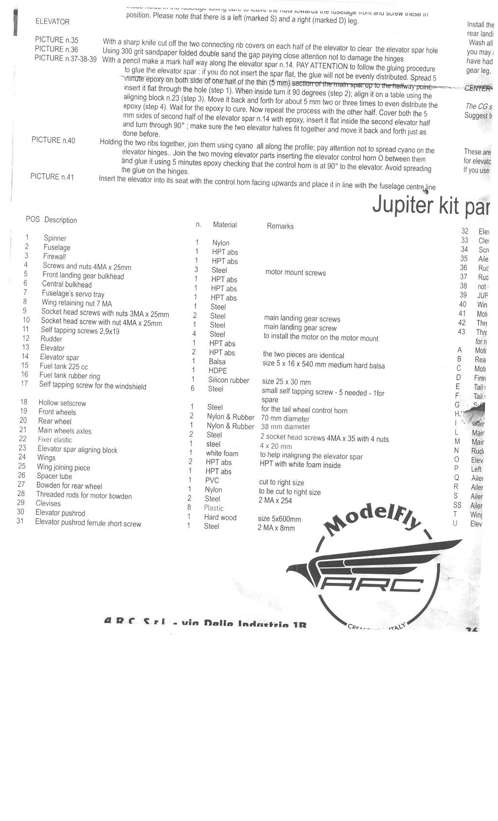

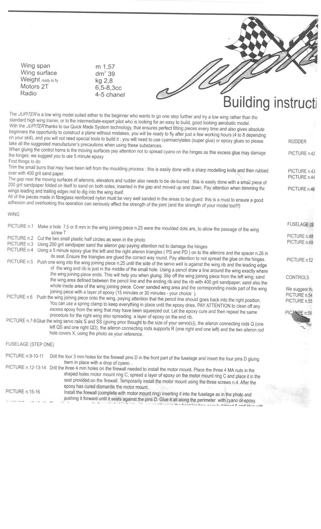

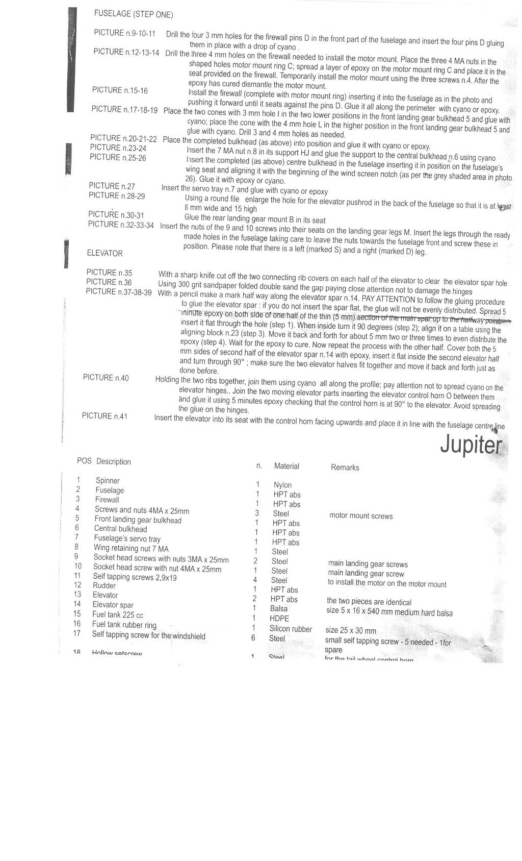

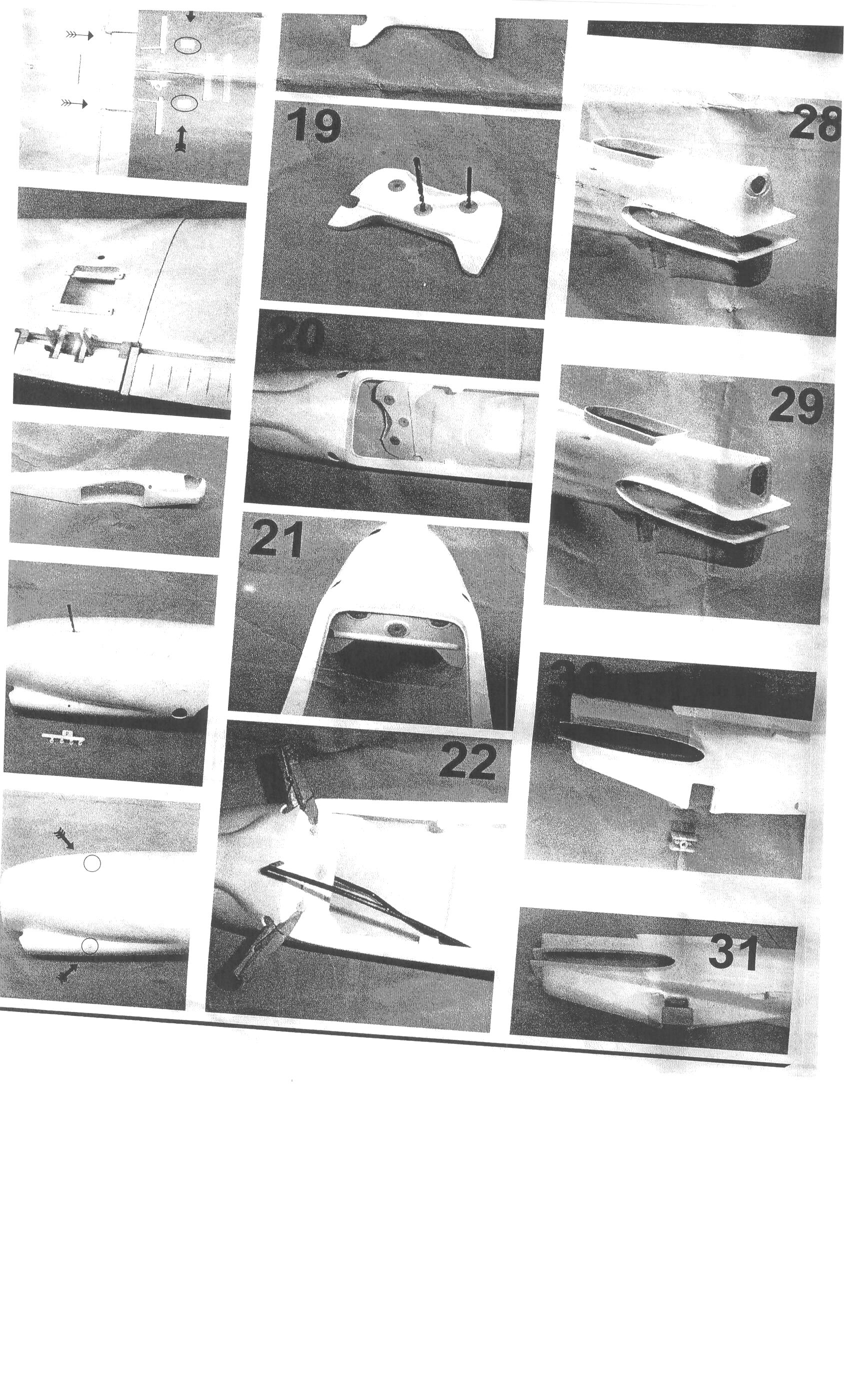

I sent it through your email, but here is another copy for someone who is interested. Disclaimer: I only provide these copies for informational purpose only, not for publishing that may violate the copyright.
