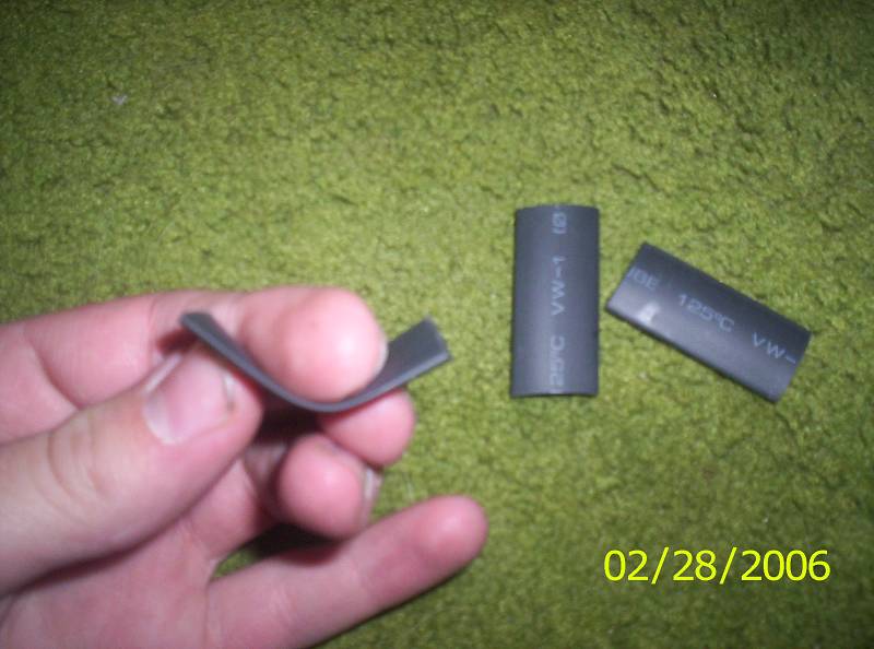

Hey, Thanks for all the advice and I think I will use the y harness, The air plane is sold at giantscaleplanes.com (lucky is the nose art). As for the shorting I will use the Short proof plug technique from the Dec /05 Issue of model air plane news under tips and tricks. I have another question though, the rudder doesn't have slots or hinges so would these be them
Thanks again, Dave Trimmer

Old 03-01-2006 | 03:26 PM
My Feedback: (13)
Joined: May 2004
Posts: 4,177
From: san francisco, CA
Default RE: 2 aileron servos, How does that work
lets hope not those don't look right you might want to use HD hinge points or see if you have a CA hinge sheet it usually is about 9" long and 2" wide. you have to cut your hinges out of it usually about 3/4X 1" then check for hinge slots through the covering your inst. book should detail this if not check the web site there alot of threads on RCU about hinging surfaces
Old 03-01-2006 | 04:11 PM
Joined: Nov 2004
Posts: 11,701
From: Memphis, TN
What you are holding is large diameter heat shrink tubing. I don't know what they plan on you using that on. Perhaps building up pushrod ends.
Is this the plane?
http://www.giantscaleplanes.com/Hellcat_70.htm

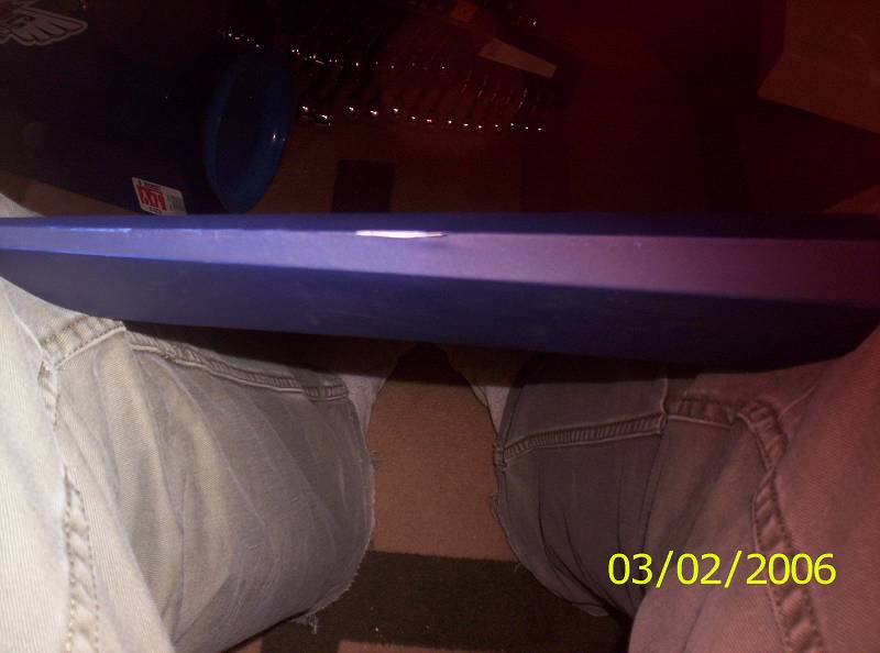

Old 03-02-2006 | 07:19 PM
Joined: Oct 2005
Posts: 496
From: Hamilton, ON, CANADA
Yes those look similar, The link from the servo to the aileron slides in and out as the servo moves, the aileron itself with the horn is fine, and there were no hinges in the pack and only one slot for a hinge (see pic below). Unfortunatly the instruction are horrible. I will also try to find out if I can call someone.
Naggingly, Dave Trimmer
Old 03-03-2006 | 08:20 AM
Joined: Nov 2004
Posts: 11,701
From: Memphis, TN
I'm thinking you mean these are on the aileron servo output arms. Sometimes the screws bind a little on a burr. Remove servo arm and wire from fitting. Then see if you can run the screw in until the head seats on the fitting or bottoms out in hole. If not, fix threads or replace fitting. If fitting screw can be tightened down fully but still slips on the wire you could file down the top of the fitting slightly to allow more engagement or replace. The wire may just be too small for this fitting also.
One hinge is not going to be enough.
