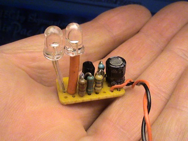

Check transmitter range...you should be able to go at least 75-100m with the antenna fully collapsed before you notice any servo jitter.
And do use a reciever battery checker!
Regards!
Jan K
Sweden

Jaka,
Do you have the schematic for that battery checker you are using??
Ken

[:-] Yes, Yes, schematic, Yes, Yes! [sm=cool.gif]
