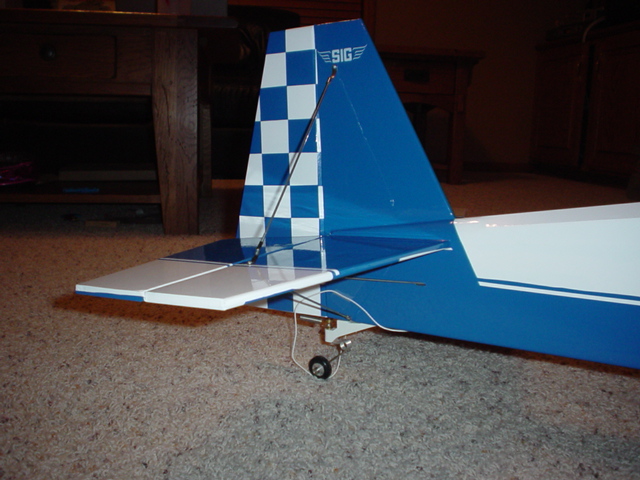

Never double back the antenna. How I attach mine is to get a servo arm that has three holes in it (cut it from the rest of the servo arm). Get a Tpin and place it where you want but be sure the antenna can reach it. There should be a gap between the Tpin and the end of the antenna of about an inch or two.
Now take the antenna and run it through one of the outer holes in the servo arm leaving about 2 or 3 inches extra length, take a rubber band, fold it in half over onto itself so if your thumb is in the middle of the rubber band you have a loop on each side, lay it across the servo arm between the hole you ran the antenna through and the second hole. Now while holding the antenna and rubber band, run the antenna through the second hole until it holds the rubber band tightly then run the antenna through the third hole and pull it snug. Now take the 2 loops of the rubber band and hook them to the Tpin. You may have to play around with how much antenna you have running through the holes until you get it to where the antenna is nicely stretched out and the rubber band is also a little streched. Any extra antenna just let it hang in the breeze
It sounds harder that it really is and you now have an antenna that will give a little bit if needed without breaking and will remain tight. I have been doing this for a while. The only time I have ever had to fix this is when glow fuel finally eats the rubber band away because I forgot to clean it when cleaning the plane.

have doubled back the extra 5" of my antenna using a servo arm piece to attach arubber band to then another at the end of the antenna to prevent it from touching it works fine as long as you dont twist the extra it will work fine. if your worried about it then take up the extra slack and hide it in the fuse. personally I would rather the extra be out side of the fuse.
Just because one gets by by folding back or other wise changing the antenna does not change the fact that they now have less range. All valid scientific tests show that performance is degraded when the antenna is shortened. That doesn't mean that you can't successfully fly with the degraded equipment, it just means that ,in that case at least, maximum performance was not required. If range is a problem or you need maximum range, then, DO NOT fold back or shorten the antenna by any means. If you want to take the time to investigate this a little more thouroghly, check out RCCAM's site. He has the equipment and the knowledge to perform valid tests and has published some of them.
