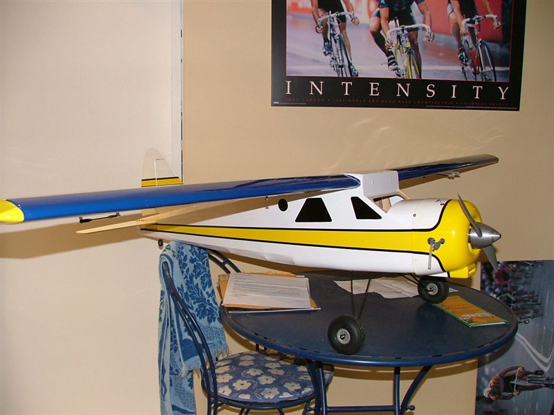

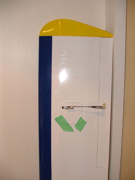

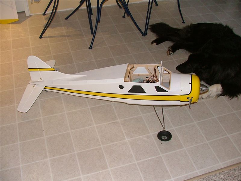

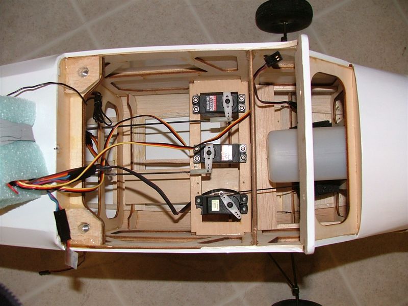

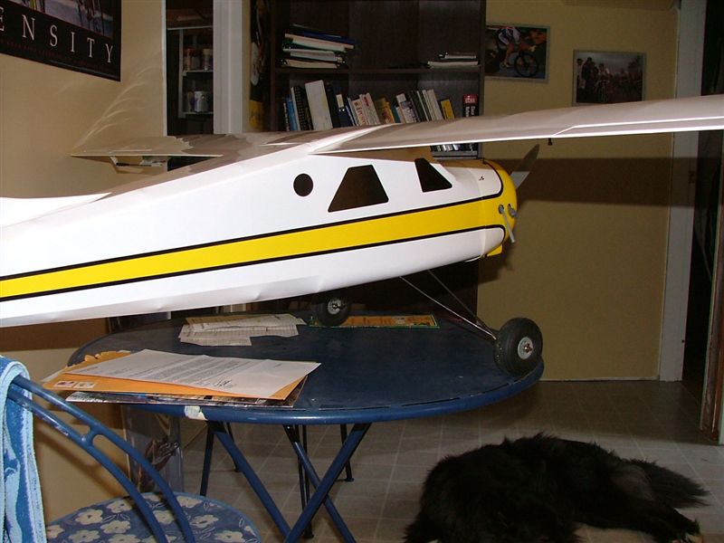

i'm not too sure whether it is or not?? have a look at this PDF... it is from VMAR but it isn't what my plane looks like at all. the ailerons are controled by two servos out in the wing ends, etc,etc. i'll grab a few photos tomorrow and post them up for people to see. i kinda think it might be a Euromodels ARF??
so far this plane has come out great but it's taken me a while because i have very limited instructions,etc. so i have to figure things out as i go. i'm almost done though, just fitting the receiver and battery and testing CG, etc. i've put on a bigger tire as our field is pretty rough...doesn't quite look like the real thing, but it's better than the little foamy ones it came with.

here are some pics.... so far....
