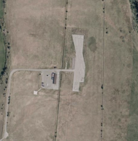

The Utah Model Port is an RC airstrip owned by the State of Utah. See attached image.
Oh, and I put up my fequency tag like everyone else.

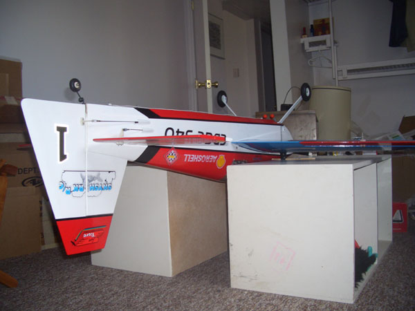

2) My control throws are accurate and in the right directions.
3) My center-of-gravity was very precisely set (see attached image)
4) As a matter of fact, I did have another pilot check the plane, and nothing was wrong with it.
I did my homework and took my time making sure everything was correct.

1) I ran 2 gallons through my engine on the test stand, my idle is 2000 RPM.
Here is a recommendation for you. Have someone film you from the moment you get the plane together, including fueling and starting procedures until you land and shut it off. Then show us this video and do not edit it at all (there are enough video experts here to tell if you do). Have the person zoom in on the plane while landing/takeoff and at various times during the flight.
Then ask us what we think.

In the pic you show, it appears that the nose is somewhat low so it is not "precisely" set.

I don't think I've ever seen a field where they made the pilots stand 150 feet from the runway to fly. That would cause trouble for people with depth perception problems. In my experience, 15-20 is more the norm. Isn't the fence the thing that divides the runway from the place the pilots are supposed to stand while they're flying?
My apologies.
By "pilot stand" I thought you were referring to the pilot pit area.
I was trying to make it clear that I didn't land the aircraft that close to spectators.
Thanks for the tip about the fuel tubing.
I'm actually re-engineering the landing gear for better stopping. I'll try that.

ORIGINAL: IL2windhawk
My apologies.
ORIGINAL: piper_chuck
My apologies.

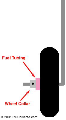

. You can slip a piece of fuel tubing on the landing gear wire and then use the collar to adjust the pressure against the wheels. These will act like brakes and help slow down the plane when landing and during taxi. Just make sure you don't put too much friction on the wheels or the plane will nose over. [X(]

Attached is a photograph of my airplane. It is a SkyShark RC Edge 540. I cannot
recommend this company enough. This plane has taken a great amount of learners
abuse from me, and she still flies fine.
