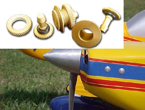

Hi,
What do Fuel Dots look like? What are the best one's to use. I searched Tower and just don't see a picture of them.

here is an example
http://www.centralhobbies.com/Fuel/f...s/tetdots.html
Here is a pic of a bit fancier one

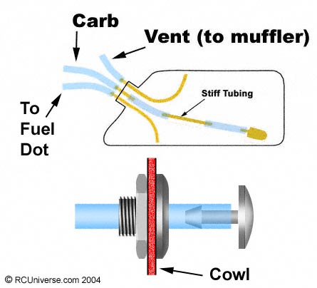

Hanger 9 makes a very nice fuel dot that doesn't cost too much. You can find them here [link]http://www.horizonhobby.com/Products/Default.aspx?ProdID=HAN115[/link]
Also, a few pictures for you
Ken

I want to add that if you use a 2 line system with a fuel dot, make sure you put an inline filter between the T connector and the engine. The reason is you are pumping fuel in that could contain trash. This is especially important if you rely on a filtered clunk as you will have fuel in the line that never gets filtered by the clunk.
