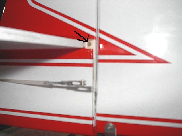

This is what im talking about ...........
that little hole there , should i just cut a slot for it to fit there.

what you are showing to us is a dry fit, or are your surfaces already glued on the plane?

lerofit- The rudder assembly and stabalizer are not glued to the fuselage.

ok, glue the joining wire in the two elevators, work flat !!!, use enough epoxy glue, be sure your wire is not fat (clean it with acetone before gluing check the hole position before gluing (see if the total lenght of the elevator assembly will not exceed the lenght of the stabiliser
check also that the two elevator leading edge are on the same line.
Usually i work agains the stabiliser (i use some tape to protect it from gluie to be sure eveithing look good
do all that on a flat table with the all assembly out of the plane
understood?

In a previous post, our friend montu said that he already hinged the rudder to the fin, this make me think that we will have some more problems. As I already said, I never builded the ARF SE , but i made several kits. In the kit version there is a hinge holding the rudder to the fuselage. What I usualy do is to glue my elevator assembly (hinged) and then then vertical fin and after that I hinge the rudder to the fuselage and fin.
In our case montu will have to glue the fin and rudder assembly to the stabiliser AND DON'T FORGET TO INSTALL THE LAST HINGE OF THE RUDDER IN THE SAME TIME .
On the last pic montu posted, I can see a hole were the joining wire go trough the fin trailing edge, this hole have to be enlarged till the end of the fin trailing edge, otherwise it will be impossible to install the rudder and fin assembly.
