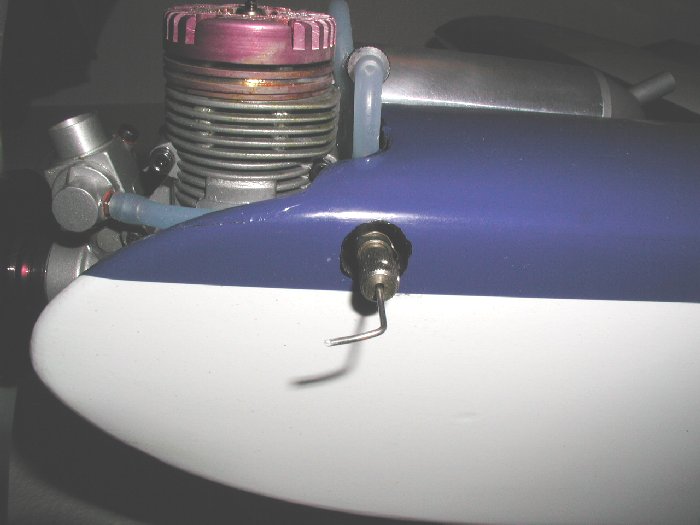

Here is a picture of Mine, hope this helps. This is what I mean about a hole for the needle valve to go through. Some people cut out a huge U shaped section of the fuselage to accomodate the needle valve, real ugly. Anytime you cut into the wood, you need to seal it from the fuel and oil. ARF's will fall apart fast if you don't seal the edges of the covering. If you protect it from the oil, it will last much longer. I will be glad to help you with other questions as they come up.

The 40 La is a rear needle but that does not make any difference as far as how you penetrate the side of the fuse. just the location. Second make sure you don't use the rubber band method of attaching the wings. They BREAK,.we use plastic wire ties and then snip them off, REALLY epoxy the hooks into the wings well and make sure you glue the rear wing dowel in well. I agree that the 4o LA is woefully inadequate for this plane. I have a 80 GK Saito in mine. Maybe a little much but balanced well and has unlimited vertical. I think from the sound of your questions that this plane might be a little too much for you at this point.

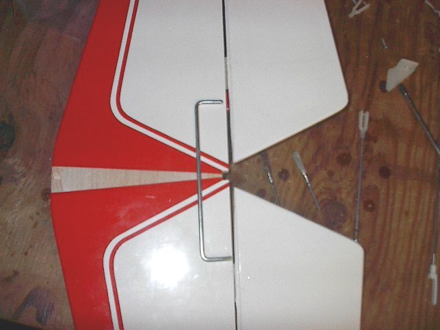

Sorry if i sounded like i was bragging. How do you get the elevators to work after you hinged both of the elevators on the stabalizer. I mean does it require on servo or two. Is there two push rods for both elevators. thanks

The elevators are joined together with one thick shaped wire, and should only need one control horn on one side to control both elevators. The plans and instructions should be fairly clear on this. Be sure to use low rates on everything with this plane. It is a jump up in required skill level from your trainer, regardless of how well you were flying it. If you take your time, let someone else do the initial flightcheck and flight. These planes are a blast to fly. Have fun!! My 2 cents.

And then what do I do after I cut the hinges , like step by step. Sorry I am asking so many question but the manual is very hard to understand to me. Plus this is my first plane I have had to put together. Is this what the elevator wire looks like......
Posts: 288
From: EU
i buided the kit of the somethin extra, i never mounted the arf, on your pic, i can see that you glued your inges already, but you forgot to glue the wire. I don't no if other friends on the forum have a kind of magic solution, but to me the most simple way to go back to normal, is to cut the hinges with a xacto, install the wire, go to LHS, buy SIG easy hinges, cut new hinges slots and reglue....

Looks like you might have too much hinge gap as well. When you cut them, and install the elevator joiner as per the instructions, try to close the gap a little more. If you can't figure out how to do all this, email me direct at [email protected] I have put a couple of these birds together. I will attach a pic of this exact elevator assembly that I just happen to have laying around.....LOL

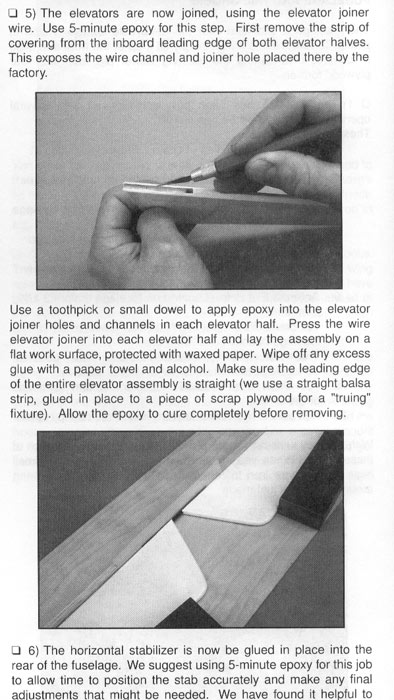

You all keep saying how easy it is but I dont see how(keep in mind this is first time with arf). I wish they had picture for every major assembly. They need picture with labels for each little part that they used for that individual step.

Ok, As I told you, I builded some SE but all kit version. Because I already made other ARF from SIG, I am sure that the procedure to install the wire is in the instruction booklet.
I am sure that a a friend on the forum who have a SE ARF booklet, will post a message or better a scan of the book with the procedure explained in a english better than mine.
I agree that your hinges gap are too big, and I hope your ailerons aren't like that. If they are, install a sealing tape or better, a strip of clear oracover.
If your rudder is already hinged also, be prepare to cut the hinges
because you won't be able to install the joined elevators with a hinged rudder (it's the case in the kit version, i am not sure for the ARF).
