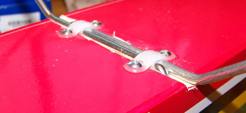

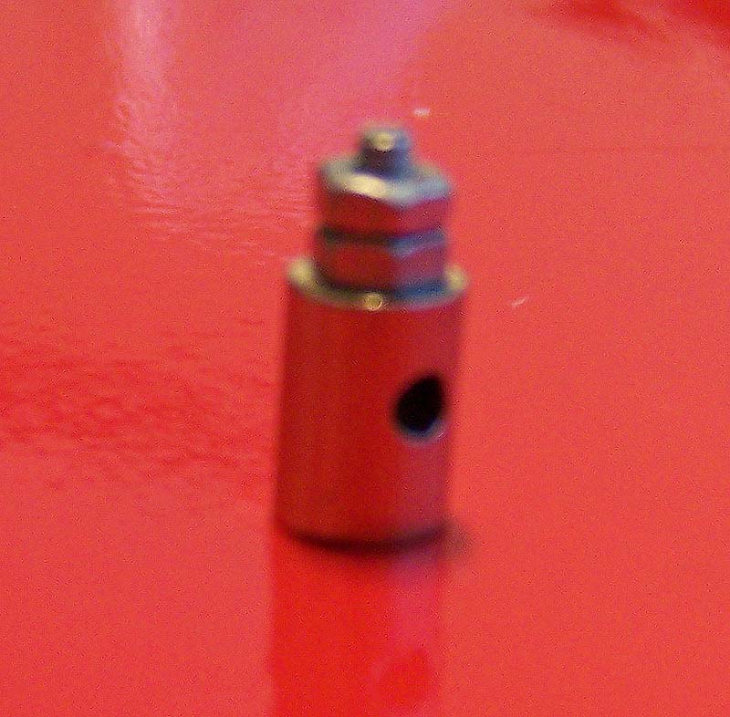

See told you I could make the hole smaller
Before and After
ID:	639093   Click image for larger version

just the rear ...the nose gear is good

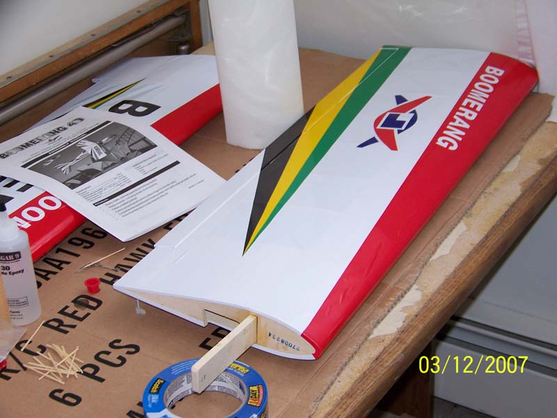

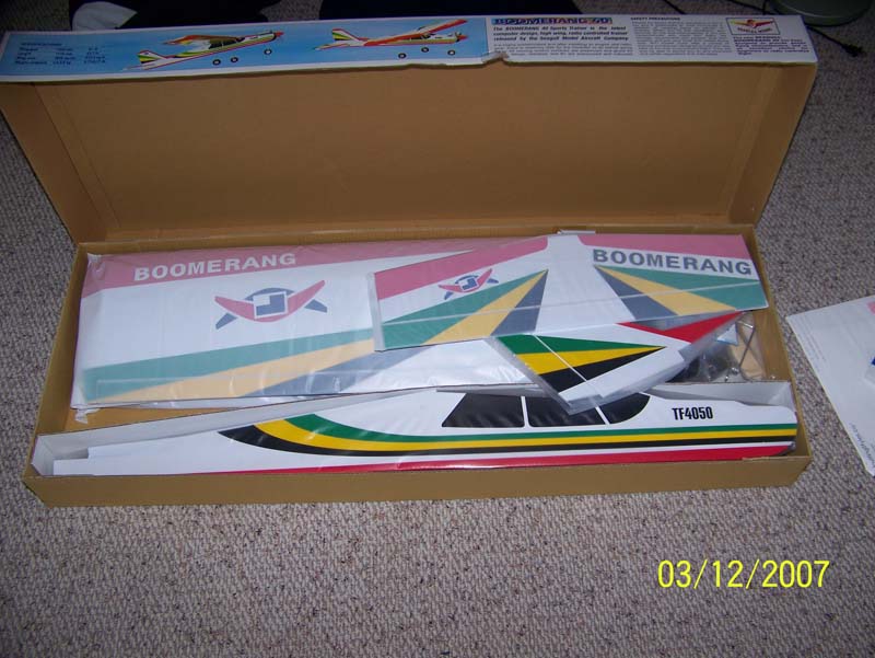

Got the rest of my order(the plane itself) today.
It's a beaut...

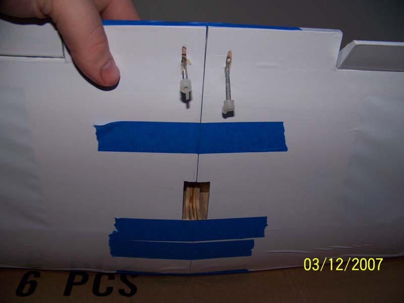

I'm gluing the wing halves together right now. I glued the first side with the joiner piece. It says that once it's cured that I can start on the other half. Does that mean I have to wait for the full curing time of my 30 minute epoxy? that's 8 hours. Is it not safe to put the other piece in and attach them after, say 2 hours?
Old 03-12-2007 | 06:04 PM
  #44
RCKen's Avatar
RCU Forum Manager/Admin
Posts: 28,244
Received 31 Likes on 27 Posts
From: Lawton, OK
Default RE: Got my first set of stuff in the mail for my trainer.
ORIGINAL: drewhosick
No, you don't have to wait that long to work with it. There are two different states of the epoxy that you are dealing with here. There is the time it takes to set and then the time that it takes to fully cure. 30 minute epoxy sets in ~30 minutes (hence the name) and fully cures in 8-12 hours. You usually only need to wait for it to set before you can deal with it, but you would be better off letting it completely cure. You can start working with the joined parts once the epoxy has set, but you don't want to fly it until it's cured. One way I use to tell if the epoxy has set is to watch what's left over after you mix the epoxy, once it's hardened up you can usually handle the part.
Hope this helps
Ken
Old 03-12-2007 | 06:28 PM
  #45
Posts: 217
From: Bancroft, ON, CANADA
Thanks Ken, I did just that. I gave it about an hour and a half or so...

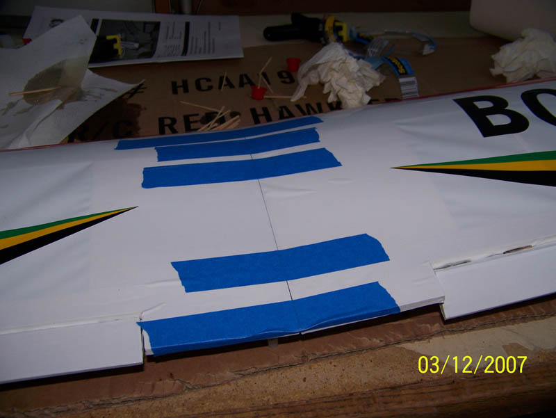

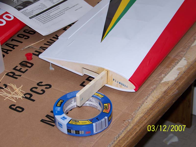

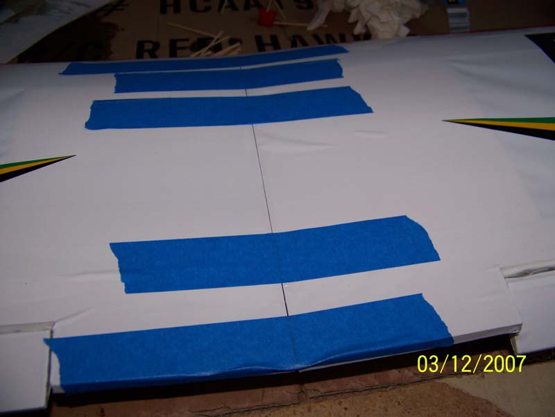

I just joined the wing halves actually. I tried getting the gap closed more but was unable to do better than what's pictured in the photos I've attached. Do you think this will work once I add the tape that goes around it?
I should mention: "THE PICS MAKE THE SEPERATION LOOK MUCH BIGGER THAN THEY REALLY ARE" I would say you can't really fit anything in between at all(not even the thinnest penny but for some reason the pics have made the seperation look wide in some places(maybe the flash)
Can you take a jab at what you think?

The gap you have should be a non issue. Most two piece wings have some samll gap. Question? Did you use plenty of glue (epoxy?) to join the wing roots together? This can be an issue later on.
I would recommend you talk with your friend and see if he has an iron or a heat gun. Shrink that covering down, you'll be happier with the end result. If no heat gun than use mom's hair dryer, it'll work, just take a whole lot longer.
Old 03-12-2007 | 06:53 PM
  #47
Posts: 217
ORIGINAL: vertigo72480
I'll talk to mom about it... but she may have issues with sending it 3500km's away LOL... I think we have a hair dryer actually and I was going to ask that down the road. Later on I'm going to get a heat gun but until I start building kits(or need to recover this plane, a hair dryer will do.
I did use plenty of glue I think... I probably mixed 2 notches of glue out of each epoxy bottle for the joining. I spread it all over the rib on each side of the wing and on the joiner as well as in the hole as specified in the instructions. I can't see why this thing would separate. My thought is, if they can make some wings hold with just tape(like the arrow(although I heard it separates on people in mid-air that way)) I'm sure I have more than enough glue plus I'll have the finishing tape over the wing joint.
Thanks a lot. I'll keep updating as I go today. I'm still intimidated by the build but a lot less now that I've put the wing halves together. It isn't as bad as I thought.

If there is a gap that runs the entire length of either the top or bottom it can often be fixed by removing just a little bit of material from the top or bottom of the center joiner. I do see a lot of bubbles in the covering, not your fault of course. A covering iron is needed to lay those back down and tighten up the covering in general. Iron the trim and seams first.

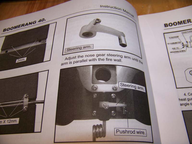

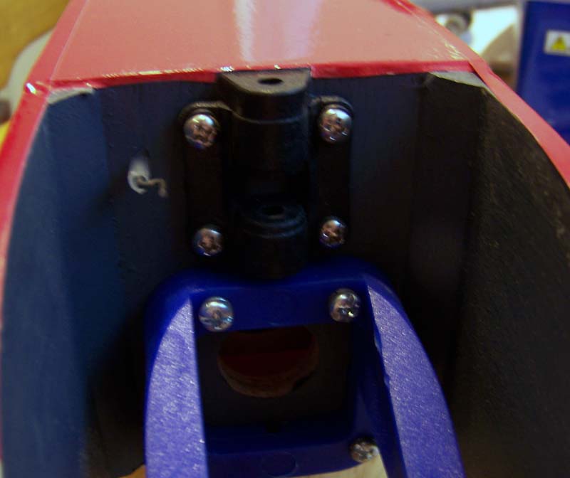

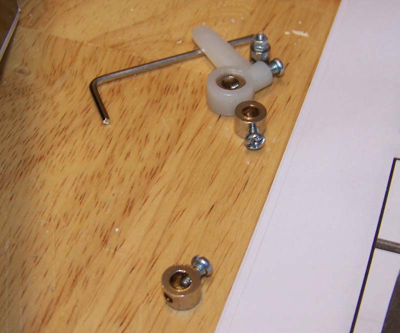

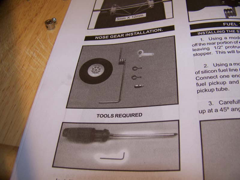

I have encountered a small problem with the install. The front wheel installation section is pure poop in the manual... Doesn't give much info on how to do it. Only a few pictures. and I can't for the life of me figure out how to install the things that go into the servo horns and control horns. They are way too small to manipulate. I've posted photos explaining what I mean
Photo 1: Just my landing gear install on the back. I'm going to see how it holds up... I heard that's the worst part of the boomerang. If and when it lets go, I'll replace it with a gear I have at home.
Photo 2: The mounting bracket for the gear.(upside down)
Photo 3: Parts they say I need(Two rings I have no clue where they go, it doesn't show it in pic at all
Photo 4: Instructions for mounting front gear part 1
Photo 5: Instructions for mounting front gear part 2
Photo 6: This is suppose to connect to the gear control horn... 3 words(what the h*ll?) How do you work with that small thing? It accepts a small allen key on the top but it doesn't seem to be able to do anytthing about the thread part at the bottom. I took off one of the nuts to try and thread the horn but I can't get any leverage on the threaded part to turn it. There's no where to do that on this peace so I can't get it on. Is there a trick to this?
