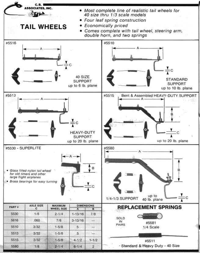

I Like the CB Associates Tail Wheels.
I have one for my Nosen Citabria.. I'll tell you how it works if I ever finish it
My 40 Cloud Dancer has the Sullivan tail wheel.. it's nice too.
http://www.mecoa.com/cb/tailwheels.htm
