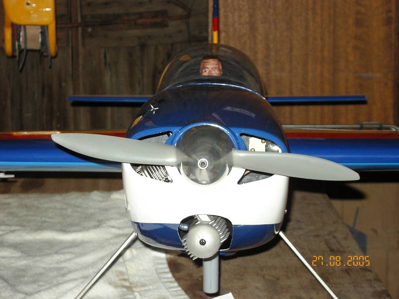

G'day Mate,
No problem at all, as long as the tank level is correct, see pix.
It also places the muffler dead centre, under the plane.
