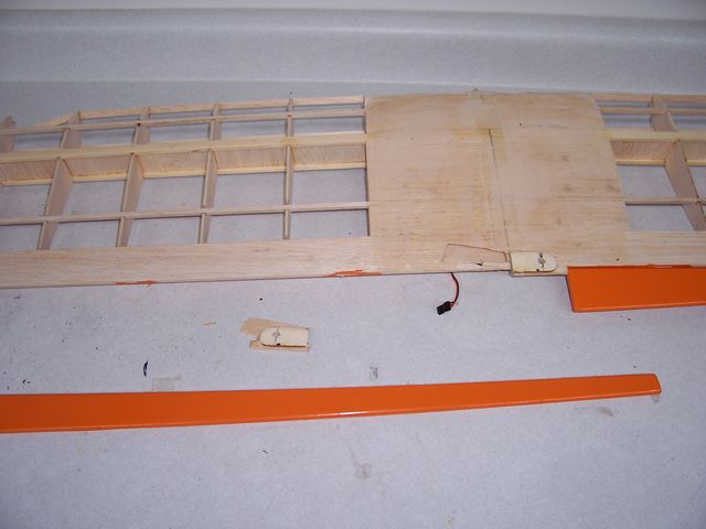

Finally got some pic`s , tore the covering off and took a look see. For coming down like it did , it is very repairable , I have been using 30 min epoxy when I glue the doublers on my builds and it seems to be working out really will. Crash tested so to speak. LOL
I`m finishing up a trainer right now for a new guy , then I`ll star on the 4 Star.
Would fiberglass and epoxy be a strong enough repair where the fuse side broke apart ?

I`ve got the fuse repaired and am happy with the way it turned out. Now I`m ready to repair the wing , and have a question ? I cut the cleaned the hinge slot out on the aileron and TE of the wing. Can I glue pin hinges in the same slots ? The T.E ans aileron are so thin I hate to cut new slots.
#36
"I cut the cleaned the hinge slot out on the aileron and TE of the wing." Is this supposed to say "cut and cleaned"?
If so you may be able to use pinned hinges. Just remember that they are thicker so they will need thicker slots. Use epoxy or hinge glue and protect the pin from epoxy. Are they thick enough to use Robart hinge pins?
