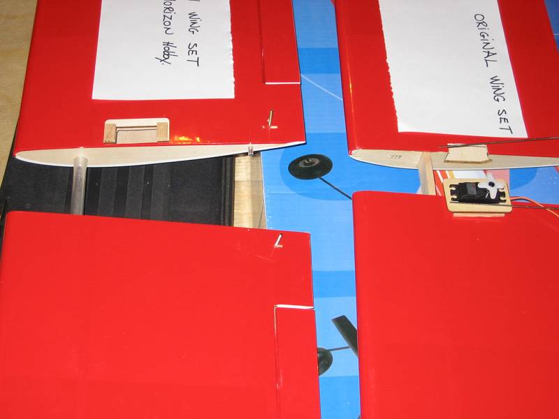

Okay, good day everybody!!!
Yes i know i'm not to fast building my plane but at least it's build up the right way.... it's funny i bought it in february lol
I had a problem when i got my plane cauz i had a crooked or bent aileron... so i contacted Horizon Hobby and they did not fool around with me they decided to send me a new wing set for my airplane.
But!!! there is a difference in between the two of them! lolll Always something.... and spring is here and i want to go try it! GRRR
There is a pre-made hole for the ailerons servo in the middle of the original wing set. The new wing set has a hole too, but it's only on one side... so not centered. I was thinking that the connecting rods will be attached strangely to the servos.... am i right or not?
here is some picture that might explain more :P lol
thank you!
Marc-André

How are the wings joined on this plane? Do you epoxy them or are the held in place with screws. If you don't have the original wing permenantly joined I would just use the good half from the first wing with the other half from the replacement wing. It looks like the hole is missing on the same half that is good from your old wing. Just mix and match the wing halves and you should be ok.
Ken

i cant! they dont have the same type of wing jonctions.... both of them are not epoxieds together yet.
i'll show you pictures.
but the servo fit in the hole of the new wing set... the only thing is that the rods wont be too too parallel

Don't sweat it. That's the new way they are doing it and it works just fine.

As Minn says, "Don't sweat it." I am training a guy at my feild on one of these right now and it has the offset servo like your new wing. While the connecting rods are canted to the side the plane flys great. It may not be perfect geometry for identical movement of both ailerons but your not going to enter a pattern aerobatics competition with it either. On a side note ensure you use locktight on the screws for the front gear. After my student's third flight last Saturday his nose gear almost fell off and two of the blind nuts fell back into the fuel cell bay. We wasted about 2 hours getting it back together and we could have had about 3 more flights instead.

As Minn and Stang have said, you'll be fine with the new wing. Just set up the new servo in the new location.

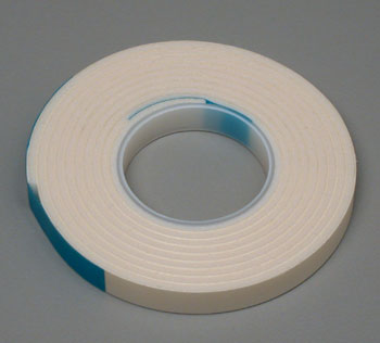

i will glue my two wings together tomorrow. OPJOSE was talking about some tape for completeness.... where does that tape goes? I guess it's to eliminate the little gap in between the wings right?
when you said : "I would also add that if you are going to use the rubber bands, that you may want to get some "saddle tape" for the wing roots to avoid damaging the wing."
sorry but i do not understand this part.... saddle tape .... dont know that either... my god, i wish i could understand all those words.
is it this?
and where would you put it?
thanks again

That's the right tape but it's discontinued at Tower. May be able to find it elsewhere. Here's something in stock at Tower just in case.
http://www2.towerhobbies.com/cgi-bin...?&I=LXK198&P=7
The other tape mentioned should just be a vinyl tape that is included in the kit that wraps around the wing root to cover the gap that may exist. 99% appearance.

Yeap.
Tower has this stuff in stock which you can cut down as needed.
http://www2.towerhobbies.com/cgi-bin/wti0001p?&I=LXK197
The wing "sits" on the two vertical portions of the fuselage.
When the rubber bands are applied, the wing and the fuselage contact each other exactly where you want to put the tape.
Place the tape on the fuselage side, not the wing. The tape is single sided sticky tape, so it will adhere to the fuselage "walls" right on the edge.
It has two effects.
1 - It prevents damage to the wing and covering.
2 - It helps to prevent having the wing move or slide while in flight.
I put it on my daughter's trainer and the wing does not shift in flight as some have reported.
