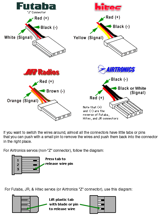

WHAT CONECTER bruce88123
Old 06-27-2007 | 10:39 AM
Joined: Apr 2007
Posts: 96
From: Lexington, SC
Default RE: SERVOS!!!!!!!!!!!!
Every servo has a wire lead that you plug into the receiver. Futaba servos have a "key" (essentially a tab of plastic) on one side of the connector that plugs into the receiver. This is done to ensure you plug the servo in correct (I assume). Not all receivers have the cutout to support this "key", in which case you need to cut that off. Hopefully this is clear, otherwise maybe someone with some pictures can better explain it.

Old 06-27-2007 | 10:51 AM
CGRetired's Avatar
Joined: Sep 2004
Posts: 8,999
From: Galloway, NJ
See picture.
Edited... picture would not upload.. local network trouble.
Will try later.
DS.
Old 06-27-2007 | 11:43 AM
RCKen's Avatar
RCU Forum Manager/Admin
Posts: 28,257
Received 31 Likes on 27 Posts
From: Lawton, OK
Here's the diagram that CGRetired was referring to (at least I think this is the one)
As you can see, the Futaba has a little "tab" on the side of the plug. You can shave that off and use it with other receivers. Also, you can use other servos with your Futaba receivers. As noted on the diagram, with older Airtronics you will have to reverse the wiring.
A lot of manufacturers are now producing what's called a "Z" connector. Z-connectors are universal and you can use them on anything. The Z-connectors are actually the same connectors that come on the JR and Hitec equipment in the diagram I provided
Ken
Old 06-27-2007 | 12:40 PM
CGRetired's Avatar
Joined: Sep 2004
Posts: 8,999
From: Galloway, NJ
That's the one, Ken. Thanks. Don't know what was going on earlier, but the local network was definitely acting up.
Anyway, the only difference from the drawing is that on the Airtronics Z connectors, the signal wire is blue. Others are yellow, orange, or white.

Old 06-27-2007 | 02:49 PM
Joined: Oct 2005
Posts: 11,517
From: Near Pfafftown NC
ORIGINAL: piper_chuck
ORIGINAL: da Rock
You can only use Futaba servos with Futaba receivers. And with Futaba extensions and Y cables.
Really? I guess I better tell my Hitec receivers to stop talking to the Futaba servos that are plugged into them!
Oops...... I forgot about the HiTec receivers that are sold as compatible with Futaba. I was thinking about the Futaba servos having that tab on the servo's connector that stops them from being plugged into any receiver that isn't specially made to accept Futaba brand servos. And those HiTec receivers not only work with Futaba transmitters but with Futaba servos.

Hey beginners.............
If you don't already know, the Futaba male connector won't plug into any female connector unless the female connector has been designed to accept the specially shaped Futaba male connector. UNLESS you take out a razor blade or knife and successfully cut off the tab that Futaba molds on their male connectors. Don't cut yo'sef. And don't slip and cut more off the connector than that tab.
Then you can use those Futaba servos with almost every other brand of stuff. Or you could buy almost any other brand of servo and use it with almost anything, including the Futaba stuff.
