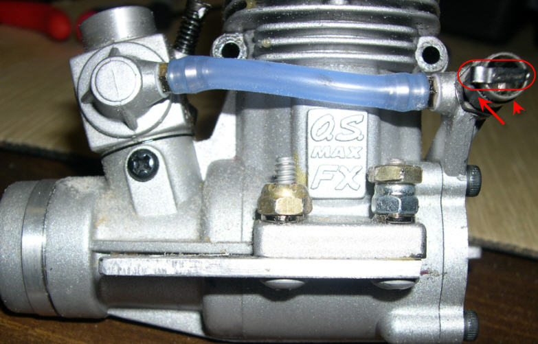

What is this Black ring like thing around the high-end needle ? It is removable and just slides in. Is it for holding the needle adjustment in place? What if i dont use it? I removed it to remove my engine since it was hitting the wood, When I put it back I dunno how tight the bent S shaped part be...
Also parts of my plane's wooden engine area are reddish /pink in color. Is the wood reacting with fuel...? not sure if it was when I bought it..also at that time everything was new to me(still is LOL)
Pls advise...thanks
-747

That part is there to put tension on the needle valve. If you don't use it your needle valve is going to rotate from the vibration of the engine running. When it moves your mixture setting is going to change and your engine will more than likely die in flight.

It looks like the spring clip that is designed to hold the needle valve in place. Yours appears to be bent as it is supposed to be resting on the top of the needle valve. I am thinking that it would be best to keep it in place. Good Luck, Dave

The ratchetting spring is indeed bent over about ninety degrees as if the engine has been set down on a table with the needle valve removed.
Hard to tell from the picture but it appears you are in fact missing the needle valve.

Hmmm Lets see , Broken engine mount. Is the needle broke off ? or am I seeing it wrong . Looks like the needle is missing or snaped off .

the needle is definatly missing,be carefull when you put the needle back in your engine looks like there is alot of wood dust that stuff can clog the needle area up.
those little buggers(the clickers my LHS calls em) snap off all the time there about 2$ so its no big deal the metal is so thin it doesn't take much.
denatured alcohol will clean the engine area and thinned epoxy,or fuel proof dope works for protecting the wood from fuel soaking into it.

Yes gentlemen, the needle is off. I just finished making steel mounts. Just that I dont know how bent the black spring should be. Can I leave it the way it is in the Pic? since it looks like its in right angles to the needle axis-looks pretty tight!

The black spring is bent too far.

You want the ratchet spring to apply just enough pressure to the needle valve to keep it from rotating. If it's bent slightly towards the center of the needle holder, and you have to push it out of the way when you install the needle, it should be OK.

As far as the little thing that keeps tension on your needle valve.....
In a pinch, you can use a piece of fuel tubing to keep your needle set. (I say in a pinch....) I've been using a piece a fuel tubing on one of my beloved 46FX engines for a couple of years in place of the little black piece. All you have to do is take the needle valve off and shove a piece of fuel tubing about 3/4" long completely over the threads that the needle valve screws into. You then screw the needle valve into the carb body going through the tubing. You'll want the tubing to almost come to the end the needle. When done correctly, You'll actually be twisting on tubing if your needle needs adjusting.
