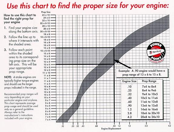

Check the prop size on the chart, find and engine to go with it, then look for a model that supports that engine size. Sounds kind of backwards as most people look for a motor , then a prop , after they have selected a model, but you may start something new here..
Good luck
Bingo
