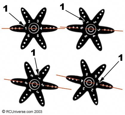

Sub-trim should be used to center the servo wheel in relationship to the pushrod, not the control surface. This way you geometrically get the same amount of throw on the rod from the servo in both directions as opposed to setting the servo up with differential. You should first try to achieve this mechanically and then resort to using sub-trim for minute adjustments. An exception to this might be the throttle where you are attempting to center a mechanical trim lever and achieve a proper idle speed. Control surfaces should be centered using the clevis at each particular horn.
goirish - I'm pretty sure it does but check your manual for sure.
foose & goirish- Futaba arms are staggered. Look at you manual. By rotating them 90 degrees you shift them 1 degree relative to the servo. Pick the correct arm/wheel position first and the use sub-trim if needed. This works best with 4 & 6 arm & wheel outputs but also with 2 arms. Again, read your manuals.
spiral_72 - close, but after the maiden you should be readjusting your push-rod lengths to recenter your TX trim levers. By using sub-trim you are de-centering the servos themselves.

Personally, I never use Sub Trim - never saw the need.
As far as Page 5 of the manual, it's a little vague.
What they are telling you is this:
First, set all of your trims to the center.
Then, place the servo arm on the servo so that it is 90° to the servo***
*** what a lot of people don't realize is that with Futaba servos, the servo arms are designed so that whenever you rotate to a different arm you will get a different angle (See illustration)

The levers (or buttons) on your 6EXA below and to the side of the sticks are your digital trims. My older 6XAs has analog trims where a wheel rotates to the right/left or up/down to adjust the control surface (in flight) then it stays there. The digital trims on the 6EXA always return to center when you nudge them to "blip" in small amounts of trim.
The advantage of digital trims is they can't accidentally be knocked off their last setting. The advantage of analog trims is you can quickly move the lever a bunch. Makes it handy to use the analog trim on your idle to cut off the engine - the throttle trim doesn't have any affect on the high side. On the 6XAs, you may not remember where the trim lever is supposed to be when you have multiple models in memory - each with their different trim settings. The 6XAs has a trim memory where after you have your airplane trimmed out (and the levers all over the place), hit trim memory which memorizes those trim settings for that model memory. Then you move your trim levers back to neutral. The control surfaces are still trimmed where you last trimmed it but you start again with a trim lever in it's center detent. Then if a trim lever gets "bumped" accidentally it's easy to find where it should be by moving the trim lever back to it's neutral setting where you can feel the center detent.
So to summarize,
The obsolete 6XAs has analog trims, subtrims (STRM) and trim memory (TMEM) which you have to set manually.
The current 6EXAs has digital trims but no subtrims. Digital trims get memorized automatically.
The 9CAPs I have has digital trims, subtrims and automatic trim memory.
