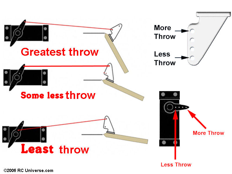

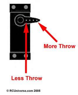

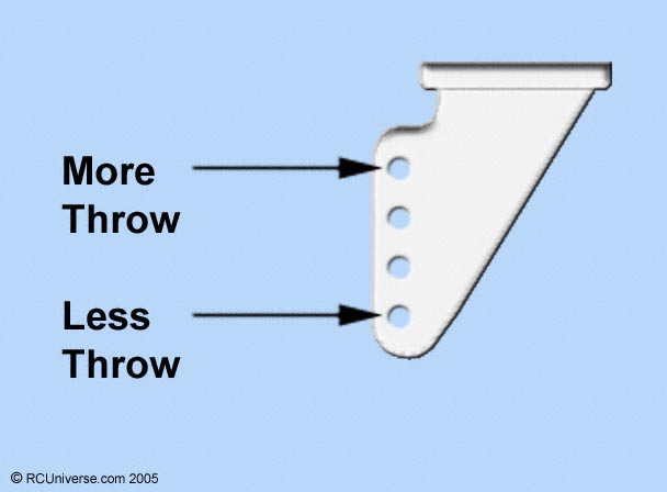

Trying to set up proper control surface travel on my Multiplex Easy glider, and having problems. Question is this: Can someone explain to me which holes on the servo arm and which holes on the control surface horn are used to get the longes travel and shortest travel. Basically not sure which holes to install the pushrods in. Thanks Nikolai

See attached diagrams
Ken

It's worthwhile to throw in some advice on this issue.
When you're setting up any connection, it's a decent idea to start out with the pushrod connected to the servo arm in the innermost hole, and the horn connection in the outermost hole. And then check for your recommended throw on the surface.
In any case, you want the lever arm of the servo to be shorter than the lever arm of the surface. If you can. And the above starting point helps insure that result.

I believe this is what was meant.

There is some basic rules you must follow when you instal the controll linkage. Those are:
Always strive to have as short servo arm as possible and always strive to use as long controll arm as possible. This should be written in stone!!!
Why ? Becuse then you will have a stiff set up!! Which is very important in an airplane.
