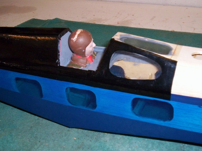

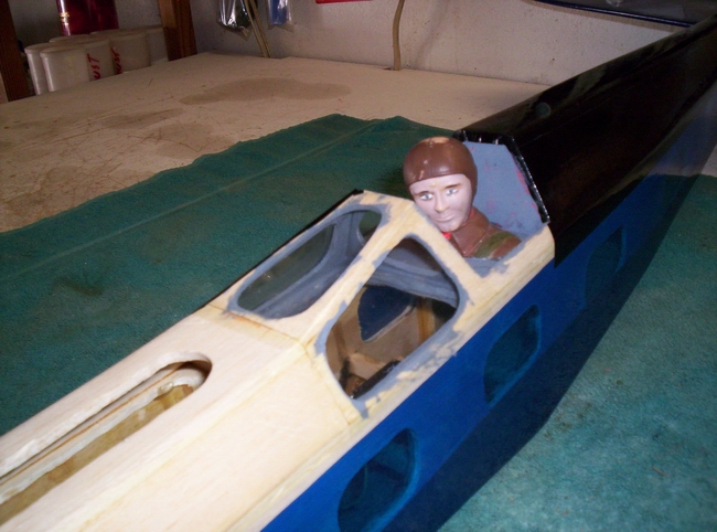

Here are a couple of typical Monocoate windows and how it is done shown by the pics of the blue Schneider. The open window bay is just covered as usual with any clear or colored transparents then a colored opaque section can be cutout with a window shape and applied over the clear.
I normally use only Monocoat, don,t care for Ultracoat it can be used as well.

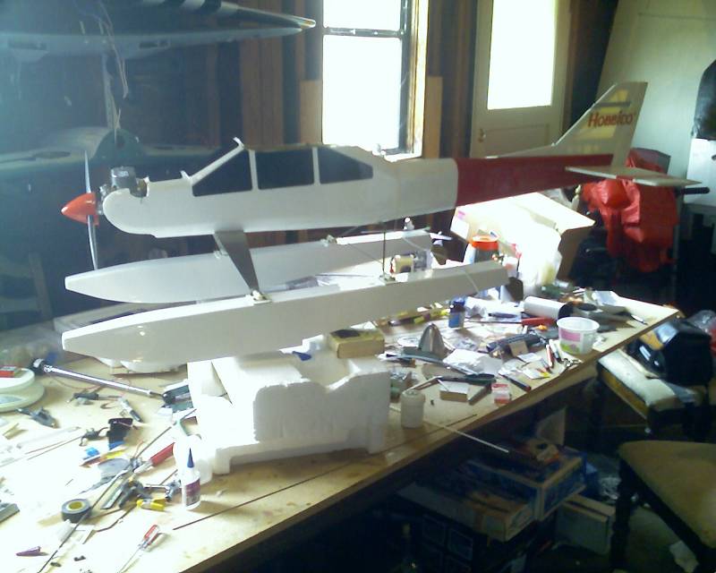

when I recovered my Nextar I used the peel and stick black monocoat sheets they come in 9"X3' sheets and are a few bucks ea.they stick to just about anything once you get them down they don't come off.
I just made a paper template and cut them out from that,I also used the stuff for simulated grip covering the top of my floats

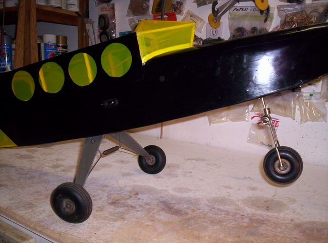

Thanks for the advice. I can only get Ultracote locally but their trim sheets probably work the same as Monokote. MY GOSH!! You've got more stuff accumulated on your work bench than I have in-toto. Of course, this is my first plane so maybe I'll catch up with you later!!

you have no idea there Fishin Geezer, thats just one, of my tables for working on planes that I have ,thats my main build table,I have a wing assembly area, and a paint and detail area.
the nextar was just a side project for something to do with a trainer plane that was not being used,I am most interested in building WW II fighter planes,they really take up alot of space.
