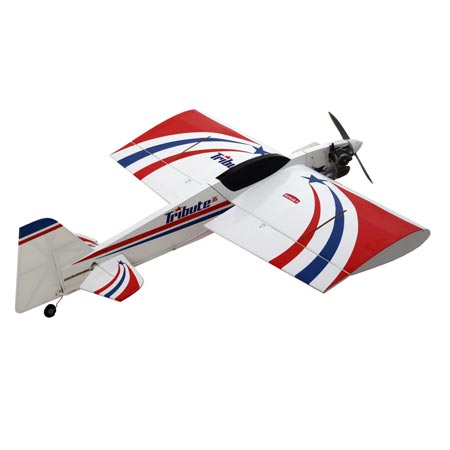

If you want an inexpensive combo, you could pair the Hangar 9 Tribute 36 with a Magnum XL .52 RFS four-stroke engine. You could buy the pair for about $210 and the Magnum would have no trouble pulling the Tribute 36 out of a hover.
I'm no 3D pilot, however, and I'm sure there are better flying airframes out there. If you want inexpensive and a four-stroke engine, however, you should give this pair a try.

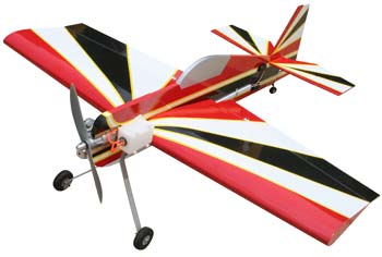

You could also consider the Lanier Radical 330 ARF:
http://www3.towerhobbies.com/cgi-bin...?&I=LXSVE2&P=0
Tower has the ARF for $69.99 and the Magnum XL .52 RFS 4-stroke for $129.99. If you use order code 011DY, you can save $25 off an order of $199 or more. Since the pair is is $199.98 for both, your cost would drop to $174.98 plus $8.99 for shipping.
If you know anybody who is a Super Saver club member at Tower, you could buy both for $169.98 after discount and get free shipping as well.

Looks like the Radical 330 ARF will wing load around 12 oz/ft2, any idea how it will deadstick?
thanks
Gator
Tower Hobbies will generally e-mail you the new Super Saver Club discount code after the beginning of each month. On February 10th, I received an e-mail with coupon code 011YG for $30 off any purchase of $199 or more. Tower Hobbies may or may not honor that coupon code if you aren't presently a Super Saver club member.
The Radical 330 ARF is miscatagorized as a .51+ - size sport aircraft, for some unknown reason. I don't think Tower had been stocking it until the recent buyout of Lanier by Great Planes, so it was added to the website hastily, would be my guess.
As for the Radical 330's wing loading and how it will deadstick, I've mentioned before that I'm no 3D pilot. I haven't flown the Tribute 36 or Radical 330 ARFs, but I'd expect either to dead stick land quite gently by simply keeping the nose down until a few feet from the ground and then feeding in up elevator to flare the plane right before touchdown.
