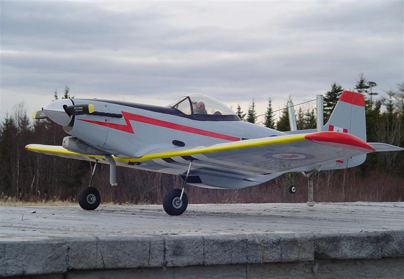

In my aircraft, the muffler or a sideways mounted engine is the single largest contributor to latteral imbalance.
I use plumbing solder to balance the plane. I tape bits on the wing until it balances, then I drill holes in the wingtip to fit those bits, and CA'em in. A bit of covering patches over the weights. I would stay away from placing them in the leading edge, this is more heavily loaded structure than the tips themselves.
If you don't have solid tip blocks, you can open the tip covering and CA the pieces directly to the wingtip framing, I guess. I typically build solid tips.
All of my planes have required a little bit of latteral balance, except the new foam winged gasser I built. Wood varies in weight, and glow engines have that huge weight on the side to keep'em quiet.
The biggest effect I've seen from poor lateral balance is a plane that's trimmed for straight'n'level will roll towards the heavy side in high-g manouvres (loops, pull-outs, etc.). Aileron trim within reasonable amounts of lateral imbalance isn't going to put much differential drag into the airframe, not enough to yaw the plane visibly. That's more likely due to improper thrust line setup, or bad rudder trim, or the vert stab is not straight.
Also, adverse yaw need never be a problem. Simply build differential into your aileron linkages. I find a 3:2 or 2:1 ratio between aileron up and aileron down works well on most models. It's easy to do. More up than down. It's achieved by having the servo horn pointed towards the surface a tad when the aileron is neutral. In other words, the angle between the pushrod and the servo horn is more than 90degrees. Maybe 100 degrees or so.

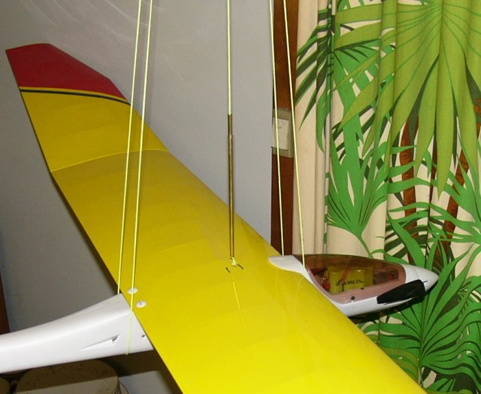

It can be a bit tricky to get just right, there're a few ways to check. Get a yard straight edge, and put it along the base of the vert. It should go straight down the centreline of the plane, and appear to bisect the spinner. Check both sides, some verts aren't flat slabs. Yours likely is. Use a small square to check that it is 90 to the horiz. stab as well.
More likely, if the plane is crabbing in the sky, the thrust line could be adjusted some. If the engine is straight with the airframe, a plane will typically crab to the left. If there's too much right thrust, it'll typically crab to the right. Adjust with washers behind the engine mount, same as when you set the right thrust in the first place.
You can get an idea of which is causing the trouble (stab/rudder vs thrustline), by taking the plane up to 3 mistakes or better. Cut the throttle back to idle and establish a good straight stable glideslope. If the plane is still crabbing, it's stab/rudder. If it only crabbs under power, it's thrustline. Quickly going from low to full throttle will tend to make a plane with a "poor" thrustline suddenly crab too.
This stuff is all part of trimming a plane. Trimming is MUCH more than just setting things to spec (CG, Thrustline, etc.), if you're gonna have a truely trimmed out plane. Very few people do trim their planes out, but they'd all benefit from understanding the process.

Hmm, no pictures, but let's see if I can describe it better.
THe wing is made up of a few parts in a typical trainer.
The spars are the beams, run the length of the wing, about 1/4 back from the leading edge and parallel to it.
Ribs run perpendicular to the spars and leading edge. They make the airfoil shape.
The tip is the piece attached to the last rib, to give the end of the wing a pleasing shape. It's often solid balsa. If you hold your arms out like wings, the tip is your fingertips. Drill in there, parallel to the leading edge, and insert the weights. Epoxy will work fine, but I find CA is neater to use, if you're careful.
OK here's my mustang. The wingtip is the red part at the end of the wing. I'd drill horizontally into that block, from the end of the wing.
Hope that helps...
J

Looking at my vertical fin from behind the plane, it looks as if it is warped to the right, which would explain why the tail of the plane tracks left. This would also explain why one of the guys who trimmed the plane had the rudder trim all the way to the left.
This is the best way I've found to check the balance of a model both fore and aft and laterally at the same time. The string around the fuselage is a continuous loop so it can slide around the supporting hook in the ceiling to get the model sitting dead level to the floor (both fuselage and wings level). The pointer is a pendulum hanging from the same hook so if the model is laterally unbalanced then it'll point off to the side. A better pointer than mine would be one of those pointy fishing sinkers though.
