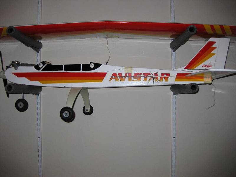

Ok, it's been a while but I finally got pics of the repair and landing gear upgrades. I removed the monokote from the area that was broken and re-covered it with plain white monokote after cleaning the area with windex. Some of the edges didn't seal well so I put scotch tape to close it up. I mounted the dubro landing gear back a little ways on the fuse so the bolts that hold it on go up through the servo tray.
I'm wondering, are the mains too far back? Hopefully it won't mess with the CG too much or cause any problems.
Comments?
Thanks!

It will effect the take off a little but you will get used to it

monokote sticks to itself great but your problem is that fuel residue prevents the glue from sticking well. you have to really clean the monocote but if still lifts i use a dab of thin ca to hold the edge or clear nail polish to seal the edge

I tried to get rid of the fuel with the windex and it did get most of it off. The parts that I was having trouble sticking were where the old covering was wrinkled and I couldn't push down on the new stuff to touch the old to get it to stick without doing damage. I tried ironing the old stuff to stiffen it up but that didn't work so I sealed the edges with scotch tape which seems to be ok. I'm going to keep an eye on it after the first flights and if it decides to come loose I'll try the CA fix.

It will require more elevator to rotate for takeoff IF the CG is correct. If the CG is wrong all bets are off. Check and correct the CG if needed. Aft gear movement and tail repair will most likely cause a CG shift to the rear - not good if too much.

I haven't re-checked the CG yet. I'll check it when I get home tonight and try to measure how far back from the LE it is. Anyone know where it's supposed to be on the Avistar? I can't remember.
How off would be too off and what would I do to fix it? I'm guessing adding weight to the front but how?

Balance it on the main spar

3 1/4" back from the LE is where the Cg is supposed to be, if its 3 1/2 it will be fine and will lift off a little quicker, but I wouldn't go much more than 3 1/2"

Quote from the manual. . . . .
Use a felt tip pen or a narrow strip of tape to
accurately mark the balance point on the bottom of
the wing near both sides of the fuselage. The
balance point (CG) on the Avistar 40 is located
3-1/4" (83mm) back from the leading edge.
The point at which your model should balance for
your first flights. Later, you may experiment by
shifting the balance up to 5/16" (8mm) forward or
back to change the flying characteristics.
Moving the balance forward may improve the smoothness
and arrow-like tracking, but it may require more
speed for takeoff and make it more difficult to slow
down for landing.
Moving the balance aft makes the plane more agile
with a lighter and snappier feel.
Please start at the location we recommend and do
not at any time balance your model outside the
recommended range

You might try cleaning with alcohol after the initial windex wipe down if you want the patch covering to stick better. It has worked better for my repair patch jobs. For balance adjustment move the battery forward - it might fit under the fuel tank if needed without using additional weight. I have done that on a couple of planes.

I guess my memory aint too bad yet huh w8ye. Actually, I've put three of these together in the last year and all of them required me to put the battery aft of the servo's to get the Cg in the right place. One of them even required adding some weight to the tail, but this was probably because I moved the .46 magnum a little foward and used a lot of epoxy when I took the dihedral out of the wing.
