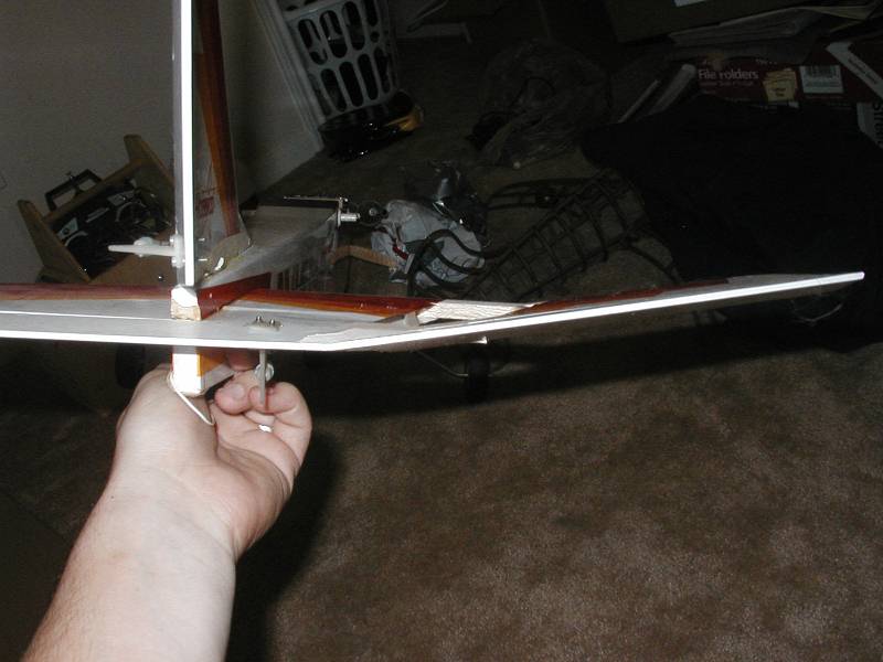

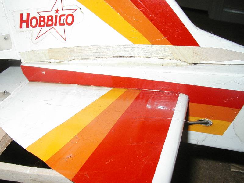

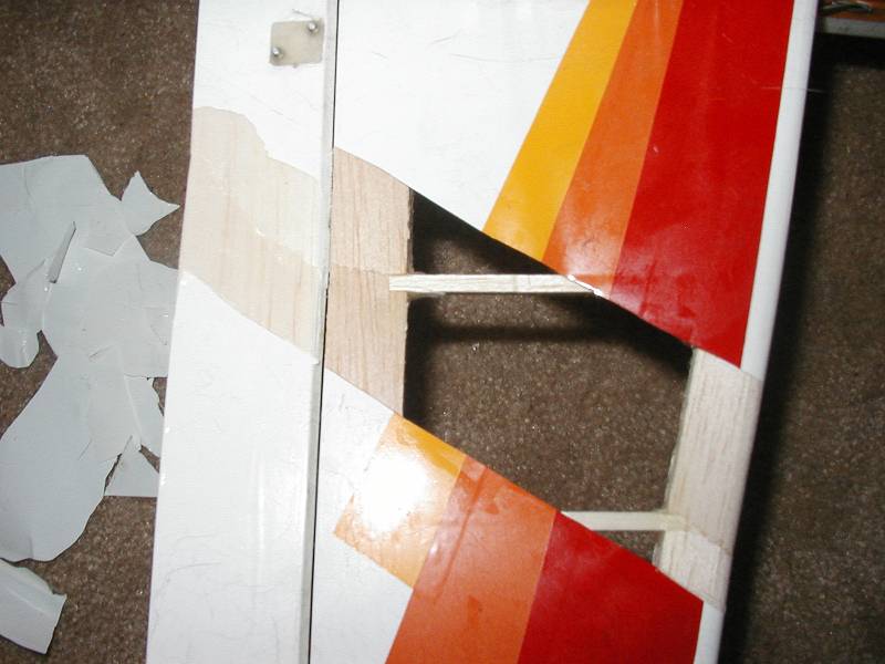

Ok, here are the pics of the broken stabilizer. While moving the plane around I realized the vertical stabilizer is broken at the bottom too. It looks like I could probably smear some CA glue or epoxy in there and have that done pretty easy. What should I do about the horizontal stab?
Thanks!

The damage is minor. Exactly as you said about the vertical stab, bend the stab back and place some glue between the cracked sections. Get some straight pieces of balsa and clamp the stab to it to make sure it's flat and straight. Recover with monokote and some trim sheets.
I agree with Ken, fixing it is easier than replacing it.
Make it straight and correct. The avistar's a nice flying plane.
Jim

You should add some tri-angle stock at the base of the vert fin for support. Both sides of course.

3/8 or 1/2 inch triangle would probably be fine. If the stab is still tight in the fuse it won't need bracing. For the broken area of stab see if you can relocate the pieces in a straight order and a little CA should hold. Think about putting doubles on anything that functions like a spar though. The entire elevator may need replacing. Just cut old CA hinges (if used) and re-slot for new ones near the old ones. Do NOT reuse old locations.

Any suggestions on how to brace the spars for the horizontal part? I can just put a flat peice on top and bottom but it would stick up from the rest of it, like a bump.

Looking at your pictures I don't think the repair is going to be all that difficult. Since the wood never separated from itself at the break you can probably just glue it all back together. While keeping the two pieces together straighten out the horizontal stab and the elevator. Once you have it straight push the two halves together as tightly as you can. Now you need to get it straight while gluing it, clamp a straight piece of wood to the top, or bottom, of the horizontal stab while you apply glue. Place the wood away from the area you are gluing. With the stab straight wick thin CA into the breaks and let it set. Continue this on all the break areas. Once it's set you should be fine. Recover the stab and it will be plenty strong enough to fly. Heck, I've had worse hangar rash (damaged caused in the shop or hangar) that I've fixed in the same manner as what I just described.
Ken

If you use a doubler, place it on the front/rear surfaces and NOT on the top/bottom.

Doublers can be useful in the right situation, but I try not to use them as they add quite a bit of weight. You can either do as Ken suggested or cut out the damaged spots at a sharp angle and replace. Using a heavily angled cut will eliminate the need for a doubler since there is more surface area to glue to. Yes, it's strong. I did this with my Joker (old pattern aircraft) wing and can still do snaps on downlines, outside loops, figure 'M''s, etc without it breaking. Do yourself a favor and use wood glue.

This is called a "scarf joint" and it is indeed quite strong. It does require precise cutting and partial replacement. I was trying to avoid these 2 requirements. The angle of the cut IS required to be at a very acute degree for best results.

I don't think I have the right tools to make a scarf joint so I'm going to try bending it back into place and using thin CA to hold it. I just have to run by the hobby shop and get some straight peices for bracing and some clamps. Then have to convince the wife to let me buy some monokote and an iron. Is there any other way to recover it without resorting to that?

No. Do it right with some monokote. You can use a full size iron in a pinch, but the covering irons are only $20. You could be back up in the air for under $40.
