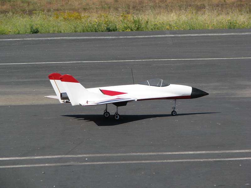

I was out to the field this morning. First day in the last tfour that it wasn't over 100 by 9am. One of our experienced guys had his jet out today. It's always awsome to watch him fly. He made a long straight up climb, and when he pushed it over, the plane did three loops within the length of the fuselage. We were all standing there watching the remarkable ability of the plane. What a susprise to see a plane that big and that fast be able to do that. After he landed and got it cooled down, we remarking on the manuvre and it turns out he was as susprised as we were. He had bumped a swith the had something to do with the thrust vector he has on it and the loops were totally unintential. I wished I had my video going then.
