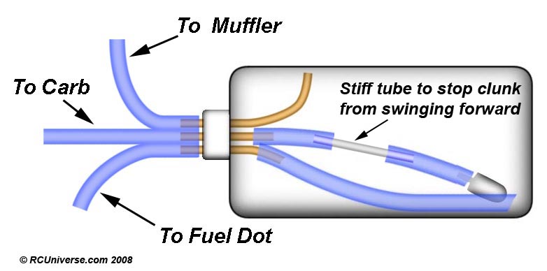

I'm not a total Noob at RC but I have an issue im about to pull my hair out about. I purchased a Nexstar Select Trainer and flew it a few times and then put it up for a year or so. Recently I get it back out and flew a couple of times with no problems and then took the thing apart to clean it and never run right since. Here is the Issue
I put my finger or the carb while turning the prop to get gas through the line into the carb. I put in the glow plug and get the engine to start. It idles fine and I can rev it up and down with no issues. BUT, If I rev it up and leave the throttle wide open, after 10-15 seconds or so, the engine dies. Not good when you are already in the air. Ive changes glow glugs, all the fuel lines, New fuel, and im at a loss here. Another thing ive notices is that after the engine stops, all the fuel in the line gets sucked back into the tank and a little comes out the pressure line going to the exhaust. It almost seems there is an air leak of some sort but cant figure out where it could be. Hope someone can help.

Look at the attached diagram and it should explain how the lines should be connected. But brief, here it is:
The line with the clunk is the fuel pick up and should be connected to the fuel input on the carburetor
The line that points the to top of the tank is the vent/pressure line and should be connected to the pressure nipple on the muffler
The line that points to the bottom of the tank is the fill/drain line and should be plugged tightely when the plane is running.
Hope this helps
Ken
You may have the fuel lines connected up the way they are supposed to be, and you could still be experiencing a fuel line issue. You need to examine your clunk line to the carburator very carefully both inside and outside of the fuel tank for any holes or tears.
The issue you're describing can happen when a small tear occurs. The engine can draw fuel at idle speed without any trouble, but once you crank up the engine, the added fuel pressure allows an air leak at the hole or tear in the fuel line and the engine can't pull enough fuel to run at WOT.

when I was flying my nextar I had a few problems with the tank, having the wrong lines hooked up was one,also making sure the rubber bung was tight enough to seal the tank so there is no air leaks.
if you suspect air getting into the tank, a good way to check for leaks is submerge the tank in water and while plugging the extra lines, blow into one of em(some clean longer tubing works well so you can see if there is any bubbles).
another thing could also be the carb seal a small tear in the rubber can allow air to get in, hard to tell my FXi runs well years later but I haven't taken it apart since I have owned it.

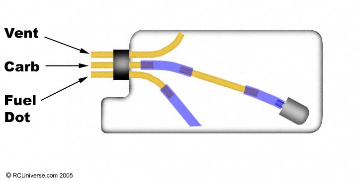

The diagram is a great example. As far as I can tell, All the lines are pointed correctly. I did put all new lines on the plane to no avail. Could there be any leaks from the engine that could case this? Crank Shaft or the bottom of the engine area.
I do have a new fuel tank with lines already in them and may use it and see how it works.
I also took the engine to the hobby shop and they said it had great compression and the piston looked fine.

I may be misunderstanding you. Your line in blue, The Carb line with the clunk is the middle outlet in the stopper. The top outlet is the vent and the bottom outlet is the fill line. I'm not sure if your saying the line with the clunk is at the bottom. Again I may be misunderstanding you. Good luck.
