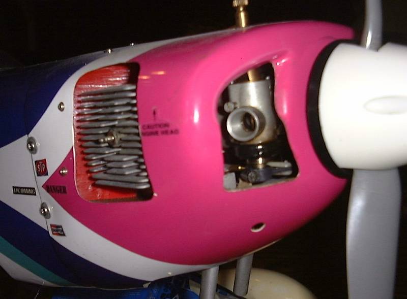

baffles look something like this

I would try flying without the cowl. If it does not overheat then I suggest that you you extend the slot around the carb. upwards towards the cylinder head. You might also try internal baffles inside the cowl to force the airflow around the exhaust side of the cylinder and over the head fins.
You need to create airflow over the engine fins and this can be bit hit and miss. I think that large cut out on the rh side of the cowl [ looking from the rear] may be counter productive.

Going by the photos it seems the engine may be too close to the cowl at the back. Air flowing past both sides of the engine try to meet up but can't so it forms a stagnant area at the back of the engine. Depending on how much room there is at the back of the engine you can try fitting a wedge shaped piece to the firewall so the point ends very close to the fins. This will give air coming either side of the engine a chance to flow around the back but even then it really needs exit slots for the air to come out top and bottom of the cowl.

As the others have said, try flying without the cowl. From the pictures you posted it really looks like you are having an airflow problem around the head. If you take the cowl off I'm pretty sure you'll see an improvement. If you do then you can start adressing the airflow issues from there.

I think those pics are someone else's plane, there to show what 'baffles' or ducts look like. I don't see any pics posted by the OP, but I imagine they would be helpful.
