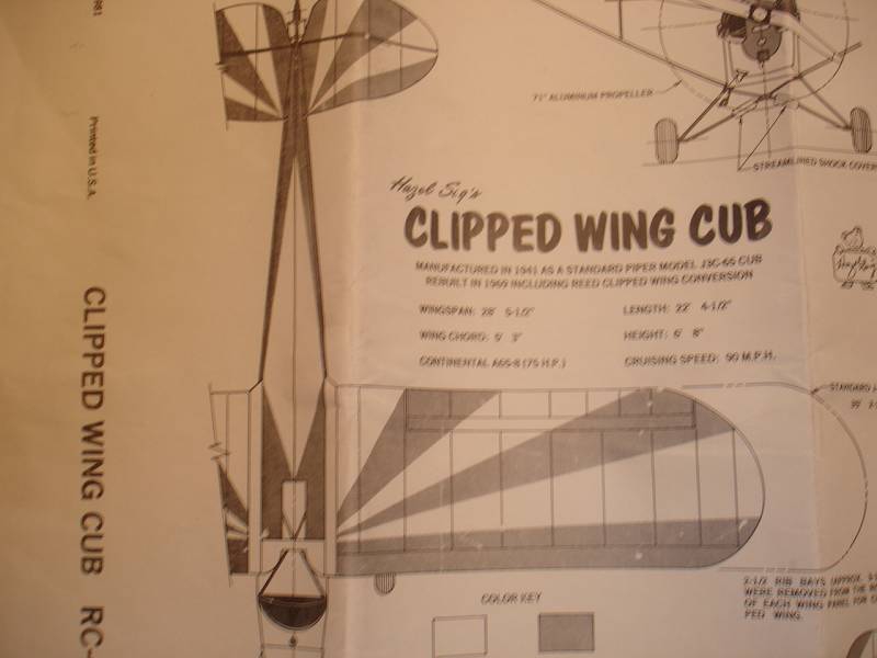

I want to cover the Cub to look like Hazel Sig's Cub. Do I put the whole thing in white then add the color? Not sure how to splice the color over the open bays. Included are a couple of pictures of the plans for the cub. not very good pictures as the light reflected back and caused it to not stay focused.

Gene,
If you are covering over open bays the easiest way is to first lay down your base color and then apply your striping color over the top of that. If you are using Monokote I would suggest using the Windex method for the stripes as it will eliminate bubbles in the covering.
Ken

Old 02-27-2009 | 10:22 AM
goirish's Avatar
Joined: Dec 2005
Posts: 5,130
From: Litchfield, MI
Default RE: Need help on how to cover my Sig Cub
Hummm!!! looking at the picture of the fuselage again, I wonder if I could put the color down first then use the windex method for the white. There is more color than white on the sides.

ORIGINAL: goirish
Gene,
You want to avoid putting a light color over a dark color because the darker color will show through the lighter color. So put your darker stripes over the white.

Old 02-27-2009 | 10:39 AM
goirish's Avatar
Joined: Dec 2005
Posts: 5,130
Ken
Looking at the picture of the fuselage do you think it can be done using the windex method?
Old 02-27-2009 | 10:51 AM
RCKen's Avatar
RCU Forum Manager/Admin
Posts: 28,241
Received 31 Likes on 27 Posts
From: Lawton, OK
Now that I look back on that I see what you mean. How much of the fuselage is open bays??? In this case you may have to go with the darker color underneath just because of the amount of dark color that you have there.
Ken

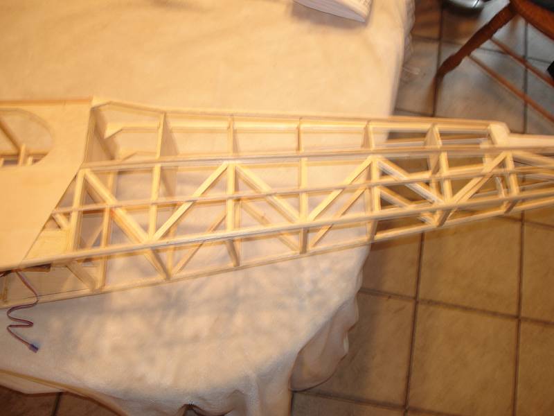

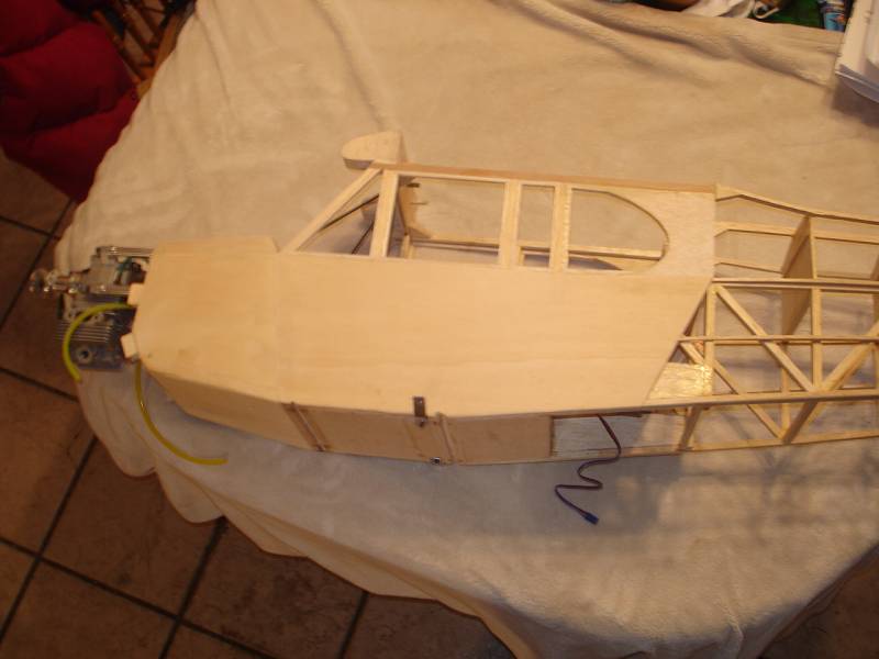

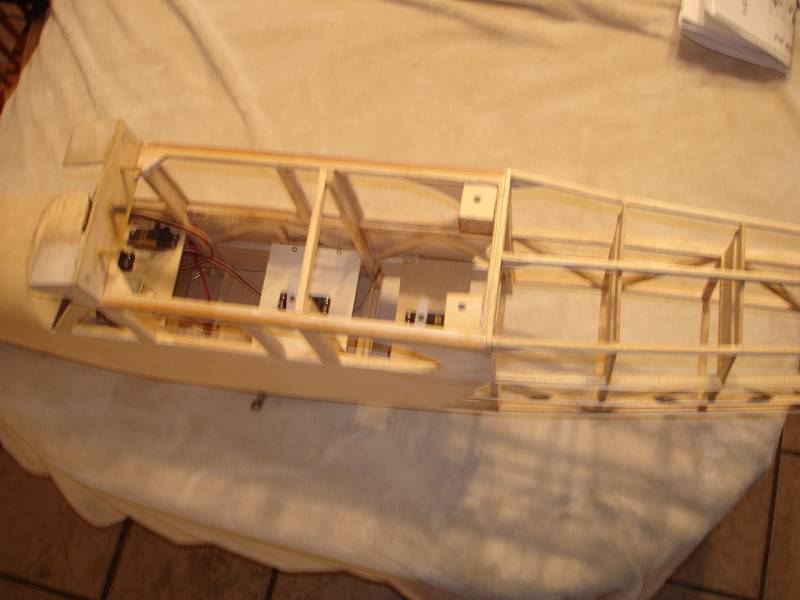

Here are some pictures of the fuselage. I must have had too much coffee. Looks a little shakey

Old 02-27-2009 | 11:05 AM
RCKen's Avatar
Posts: 28,241
From: Lawton, OK
Gene,
Ok, in this case you are probably going to have to go with the darker color over the bays and then put your white on top of it.
Ken
Old 02-27-2009 | 11:06 AM
ChuckW's Avatar
Joined: Jun 2006
Posts: 5,165
From: Clovis, CA
It looks to me like you will have no choice on the fuselgage but to either piece it together or put the white over the blue.
If you put the white over thr blue it may show through a little but it should still look good so long as you do it the same over the enitre plane and it all matches.
I used white Monokote over some purlple Ultracoat once. The white was affected slightly but it was still pretty good.
Another thing you can do besides or along with the windex is to acurately mark your trim areas over your base color then use a wookpecker tool or a pin to perforate the base. This will help give trapped air a place to escape and result in fewer bubbles.
