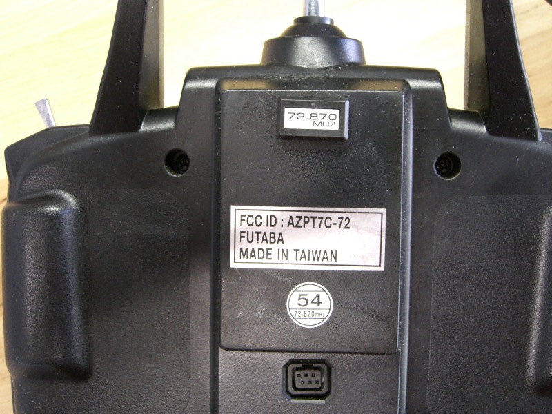

Hello all. i am new to flying ( havnt started yet ). I built a few planes when i was a teenager but never actually flew them. My wife knew i was interested in RC planes and bought me a hanger 9 P-51 arf. I know this isnt an ideal trainer. My uncle supplied me with a trainer that my 2 older boys and myself could learn on. It has no servos,RX or TX.I bought a Futaba 7cap from ebay ( not here yet ). I was wondering if anyone would point me in the right direction in the way of what RX and servos to get. I want to outfit both planes with the ability to use them from the 1 TX. The trainer is a 4 channel and the P-51 is 6 i think. Ther servos i found that i thought would work are the Futaba 3152. As for RX, i need 2 and have NO idea what to use. Is the 7CAP crystal? do i need to get 1 crystal for the TX and 2 for the RXs? or is the 7CAP the kind of radio that is programable? All i know about the TX is that it is 72 MHz? Some one plz help, i am lost []

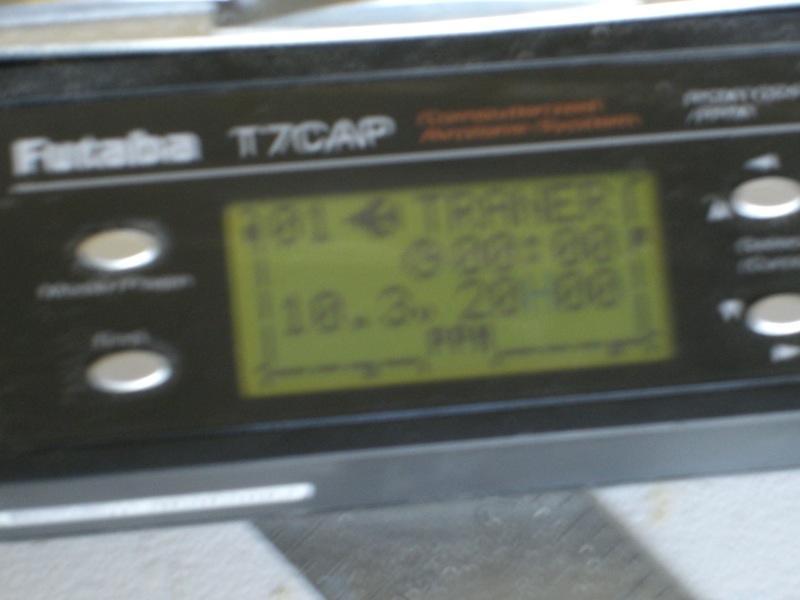

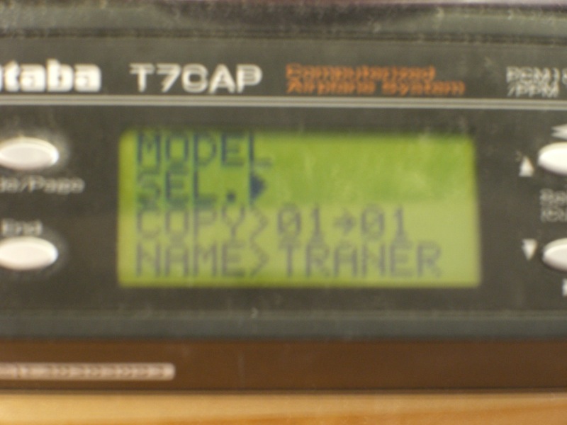

yes it uses crystals and should have one in it with the channel number on it. The radio has multiple model memory. SO you get a bunch of receivers with the same channel on it. To change plane you go into the settings and set it to the model your flying. I get these for new models. [link=http://www3.towerhobbies.com/cgi-bin/wti0001p?&I=LXMHB1&P=0]flight pack[/link] For 80% of my stuff up to 60 sized I use the 3004 standard ball bearing servos, for trainers even a 3001 standard non ball bearing servo will work just fine. I usually get the flight pack without the nicd and get my own 2100mah nimh packs but the nicds are just fine. with these flight packs you'll also have to get a crystal [link=http://www3.towerhobbies.com/cgi-bin/wti0001p?&I=LXBFK8**&P=V]futaba crystal[/link] Do not get a thrid party crystal. if you go with say a hi tec flight pack then get a hi tec crystal
the pics I've gone through a couple screen, notice the name and model number change, that's your different set ups for different plane, I think I have 5 on here at the moment and 4-5 on my other radio.

can someone that is familar with this controller please inform me... what is the numerical data to the right of the voltage reading? mine says 18H33 .. does that mean the transmitter thinks the battery will last another 18 hours and 33 mins? no way. The manual points-out every other reading on the display except this one. Can someone please tell me what this is supposed to be telling me? Is it a lifetime timer or a "odometer" for the transmitter that is counting up?
Thanks.
Chris
Old 05-20-2009 | 09:44 AM
redfox435cat's Avatar
Joined: Mar 2005
Posts: 1,469
From: Lompoc , CA
Default RE: Futaba 7cap/chp
if your not resetting it then it how long you've operated the trasmitter over it's lifetime. in your case 18 hours and 33 min. it meant as a flight timer. so if you know your tank lasts about 12 min and your using the timer ya would knw yit time to land after 11 min.
