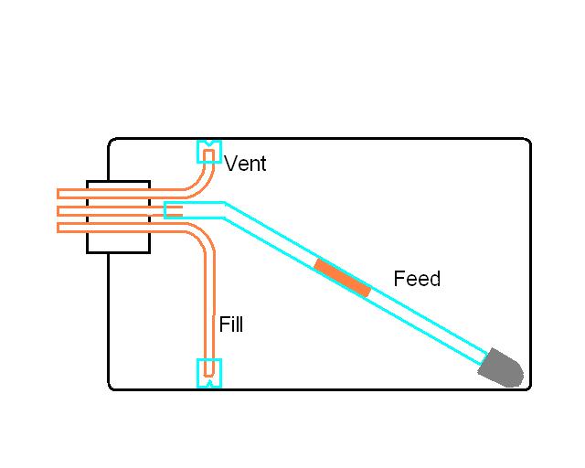

i'm using with great success these on a third line:
http://www3.towerhobbies.com/cgi-bin...?&I=LXAHE1&P=7
http://www3.towerhobbies.com/cgi-bin...?&I=LXK138&P=M

To each his own, I hate 3 line systems, unless you have a tank that allows for 2 clunk lines how do you empty the tank at the end of the day. I use only Hayes tanks and 2 lines systems with the DuBro fillers, as I said have had very few problems. If you like another set up so be it.

i use this setup and its fine but there is a tiny bit of fuel left sometimes depends on how much i'm willing to pump it out.
to drain the tank at the end of the day i lift the tail so the tank floor will be parallel.
on the tip of the vent and the fill line i put a small piece of fueling tube and cut two notches so it will keep a hole when its touching the top and bottom of the tank.
its not the perfect solution.
there is also this article: http://www.rcuniverse.com/magazine/a...rticle_id=1068
