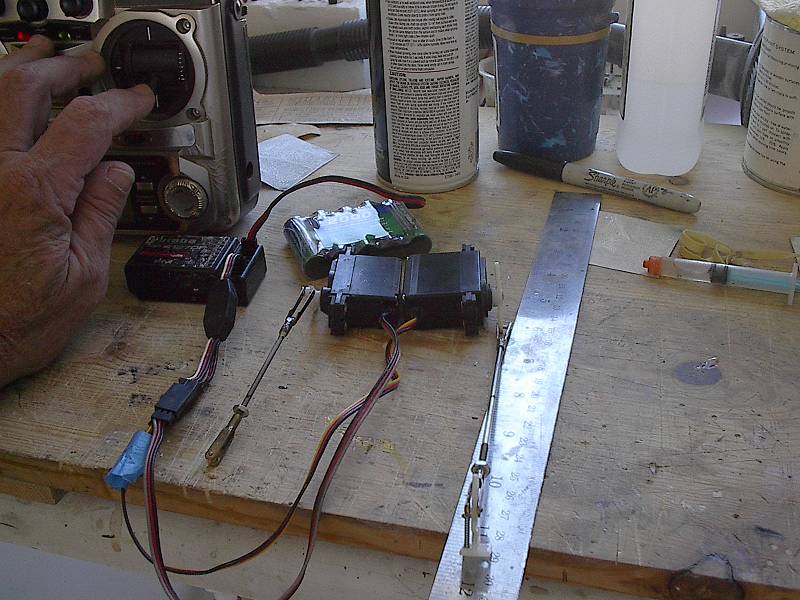

I just had to go out and set these up to see something for myself, I have one of those gray thoughts floating through my brain, it's sort of a lost memory of things done in the past. For one reason or another I have set up a plane this way. Why I would I haven't a clue and it may just be a random thought and never really happened?[&o]
Anyway, both servos are facing the same way, I just set up one control rod on the high side of the arm and one on the low. I set up the arms so the throws were equal or close to it then went into my radio and set them closer with sub trim, it works but there is a problem!!
Linear control arms they aren't!!
Would I do it this way?? NO!! But I am showing it can be done, it just isn't right. I would never set up a nice 1/4 scale anything up this way. I have a 9ch radio and I don't need to be doing things like this. I don't like Y harnesses but if it's a cheap plane go for it, if not then quit fooling around and buy a nice little JR match box if your radio hasn't got the correct mix.

ORIGINAL: ChuckW
OPjose, I understand what you are saying. That could be made to work. It would be difficult to get exact and possibly require some creative servo positioning depending on the plane to make everythign clear but it is theoretcially possible as you have obviously proven. Flipping one servo forward and one backward though will not work.
Yeah it's not normally done. And it really looks strange... violating RC estetics... and it does nag at you as you wonder about setting things up this way...
I really prefer other solutions, such as a Matchbox, a reversed programmable servo, etc.
The one that didn't work well for me was the reverser units that are sold in-line built into a "Y" cable.
Other of my club members have experiened the same problems I have had with them, the drifting with temperature, and the POTS varying with usage.
