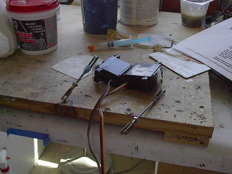

ORIGINAL: skyhawk029
take a look at the pic with the two servo, take one and have the output shaft towards the front of the plane, and the other have the output shaft towards tthe tail, then you can use a reaglor y harness, just make sure you are using a matched set of servos

I don't understand?
If the linkage for one elevator is attached at the top of the servo arm, and another at the bottom, then the elevators will move in the same direction.
If in turn you are careful with the linkages so they end up the same effective length, then you get equal movement much like a dual heli linkage.
The key is to have each linkage "half" describing the hypotenuse of a right triangle, where the servo screw is equidistant to the hinge point.
I have my Bobcat 50 set up as described, and it works fine. There is NO fighting of the servos with each other because of dissimiliar geometry. I did not have to use TX mixing, nor waste a channel, nor use a servo reverser or matchbox.
It just looks a little weird, but that's all.
OPjose, I understand what you are saying. That could be made to work. It would be difficult to get exact and possibly require some creative servo positioning depending on the plane to make everythign clear but it is theoretcially possible as you have obviously proven. Flipping one servo forward and one backward though will not work.
