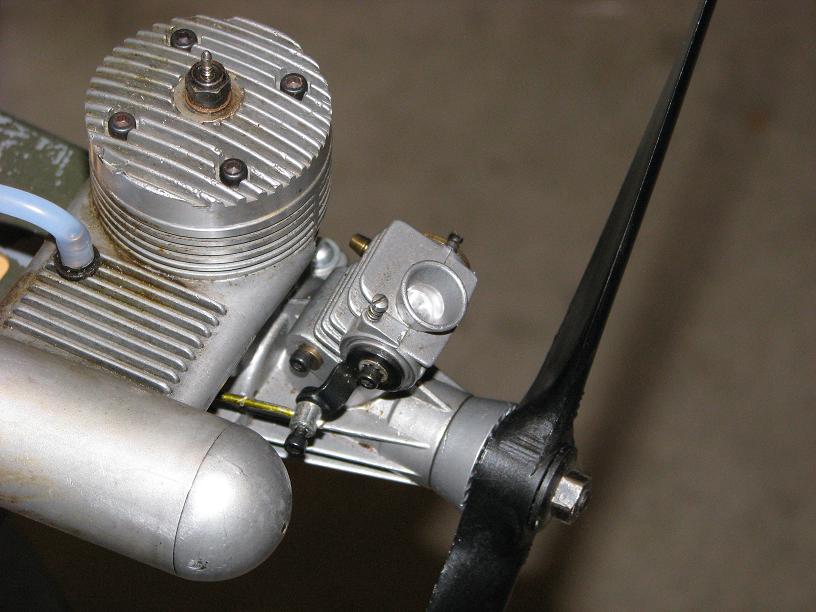

I have a size .60 k & b that wants to run backwards. when it does run forward it seems sick and weak. Anyone know what is up with this?

What carb. does it have on it sounds like it is running rich. Let hand rotation to run.

Wanting to run backwards is a common thing, My 46ax does it all the time. Mine does it when I prime it to much before I start it. Yours sounds a little rich like Live Wire said, try leaning it out a little and see if that helps.

Usually it's a sign of overpriming but have you run this engine before? I'm not very familiar with K&B engines but I believe there was a reverse rotation crankshaft available for some. If it wants to run great in reverse then that's the likely culprit .

You never said which carburator you have. can you take a pic. of the motor and then we can tell. They put out the standard and the pumped engine and the carb's are different.

I will try to get a picture of the carb and send it to you.It looks strange. It has a plate on the side about the size of a dime and a screw on the outter edge of it that does not seem to do much. None of my other engines have this set up.

That sounds like a Perry carb. Very good design at a time when many carbs were difficult to adjust and perform well. Does it look like the ones on this web page:
http://www.perrypumps.com/prod01.htm
There is a small volume inside the carb that holds fuel, so it can run for a while when the fuel is disrupted from the fuel tank. And I belive there is also an internal fuel filter, which can clog up with conjelled oil. So a careful cleaning may solve your problems. It also depends on an O-ring or two. It's been a very long time since I've had one apart.

some pics

ok that is not a veco it is a K&B sportster that has a remote needle valve that is not shown in the pictures.If you are just connecting the fuel tank to the fuel nipple on the carb you have no way of requlating the volume and it is real rich.you need to get the remote needle

as far as the engine goes, the "dime" looking thing on the side is the low speed mixture screw. it only move 1/8" either way from center. it controls an eccentric that regulates the venturi on the carb
