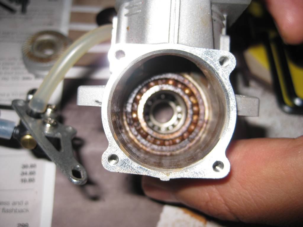

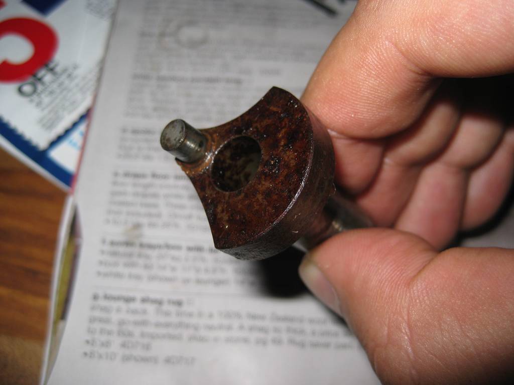

I have an OS 46ax which I havent used in almost 2 years. Last I used it, it wa relatively new, about 6 months old. In preparation for one of my winter builds, I was looking through the exhaust port and noticed some grainy particles sitting on the piston head. So I decided to take the engine apart just to cean it all up before I ran it again. Well this is what I found - see pics. I dont have engine rebuild experience other than basic reassembly, so dont really know if its anything to worry about. Seems like very light corrosion on the back plate, crankshaft and rear bearing. How can I correct this? Could I just sand down with very fine sand paper or dremmel, would I need to replace? Any help would be appreciated. Im assuming the rear bearing will need to be replaced.

use an sos pad wet to clean up the backplate and crank and replace the bearings.about $15 shipped for stainless
http://www.rc-bearings.com/catalog/p...roducts_id=715
Old 11-28-2009 | 09:48 AM
Joined: Aug 2003
Posts: 731
From: hingham, MA
Default RE: Getting engine back in service.
The bearings are shot. the regular parts can be saved by removing the rust like whatiworks4 says. to replace the bearings put the new bearings in the freezer to get real cold and then heat up the engine block with the old bearings in it. the hot engine should allow the old bearings to fall out when you strike the engine on a flat wood surface. do not force the new bearings in with anything metal use big wooden dowels to protect the bearings. keep engine warm when putting in cold bearings

Thank you all!!! Im just glad it can be saved. It will be going into my first profile.
Hmmm....SOS pad, isnt that a bit aggressive? I wonder if dremel makes a steel wool disk, so I can get into corners and get a clean result.
Just ordered the bearings, $13.29 shipped. Big difference from the Oem cost, and these are stainless steel.

There isn't any real way to tell if you have a bearing problem or not from a photo, the color or even a little rust may have had no effect on them at all. Living in an area of the country that is humid you will often have a bit of a rust problem. Like Kool stated, I would at least run my engines empty at the end of the day. I'm not a big fan of after run oil but it doesn't hurt to give the engine a little shot at the end of the day. I would just clean your engine and put it back together and give it a try. Just oil up the bearings and give them a twirl then flush them with alcohol and oil them up again. If they are bad you can feel them grinding. Don't get too freaked over a little rust, it isn't the end of the world, clean it up and give it a try.

Paraphrasing from a very reliable source ...
Bearing removal. Rear: heat the crankcase around the rear main bearing 'til hot (use a glove or towel). With a solid downward motion, hit the rear of the block against a pad of paper or a piece of leather. The bearing will jar loose. Front: heat the crankcase around the bearing, tap the bearing out with a wood dowel and a plastic hammer.
Bearing installation. Freeze the bearings. Rc-bearings ship theirs in nice small ziplock bags - just toss it in the freezer. Rear: Slide the rear bearing down over the crankshaft 'til it bottoms out. If it won't slide down because the bearing is cold and the crank is warm - freeze the crank too. Heat the case around the bearing seat. Insert the bearing-n-crank with a wood dowel inserted into the back of the crank. Then seat the bearing into the case and use a sharp blow of a plastic hammer to seat if necessary. Front: heat the case around the front bearing seat. Have a solid surface with a hole drilled to accept the front of the crank. Place bearing over the crank and position the assembly so that the crank will go into the hole, then use the wood dowel inserted into the back of the crank and a plastic hammer drive the front bearing into its seat.
A reassembly note: the connecting rod big end hole is flat on one side and beveled on the other. When you reassemble, the bevel is installed towards the back plate.
Another approach:
slide the main bearing over the crank & seat it.
freeze both bearings & crank.
heat the case in the oven at 300 degrees.
insert the crank into the warm case - the bearing may seat beautifully - make sure that you keep the bearing seated while the hot & cold items equalize.
slide the front (frozen) bearing over the crank and it may seat itself.

Thanks for the support guys. One more question: Once I remove the rust, what should I be coating the engine parts with during the rebuild stage?

I use air tool oil as my assembly lube applied with a q-tip. After run oil would work too.

Got it all cleaned up...now a little heat to dry up any moisture. Question: Only 1 part left if I can figure this out - How do I get the connecting rod pin out of the cylinder. I pulled out the little clips in the cylinder, but cant get the pin to slide out. Tried tapping it, nothin!!!! Any ideas?

I GOT IT - placed it in the oven at 200 for 20 minutes and it popped right out.
