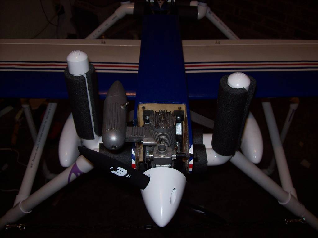

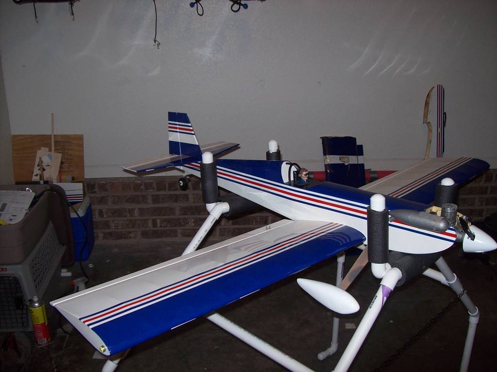

Can we get some details on this plane. What engine, battery and receiver? Where did you locate the flight battery. The easy answer is to put on stick on weights available at most hobby shops but I hate adding weight to a plane. The 4 Star has the excess wing loading it realy wont make a difference though. If you want to do it the hard way you can relocate the rudder and elevator servos to the tail as seen in my picture here of my 4 Star 120. But unless you put a 60 size engine on the 4 Star 40 then you should not have to. I did put a TT .61 Pro on a GP Big Stick 40 and had to relocate servos on it as well also pictured below.

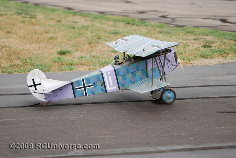

Also remember that when taxiing a tail dragger, hold full "up" elevator. This applies downward force on the tail wheel giving it traction. I just hold full "up" all of the time on the ground until my takeoff roll, then I slowly reduce elevator as needed through the roll out.
With the WW1 aircraft, we have to add "down" elevator with a blip of throttle to get them to turn. I just love the little quirks of the tailwheel. I do not even fly trikes anymore.
