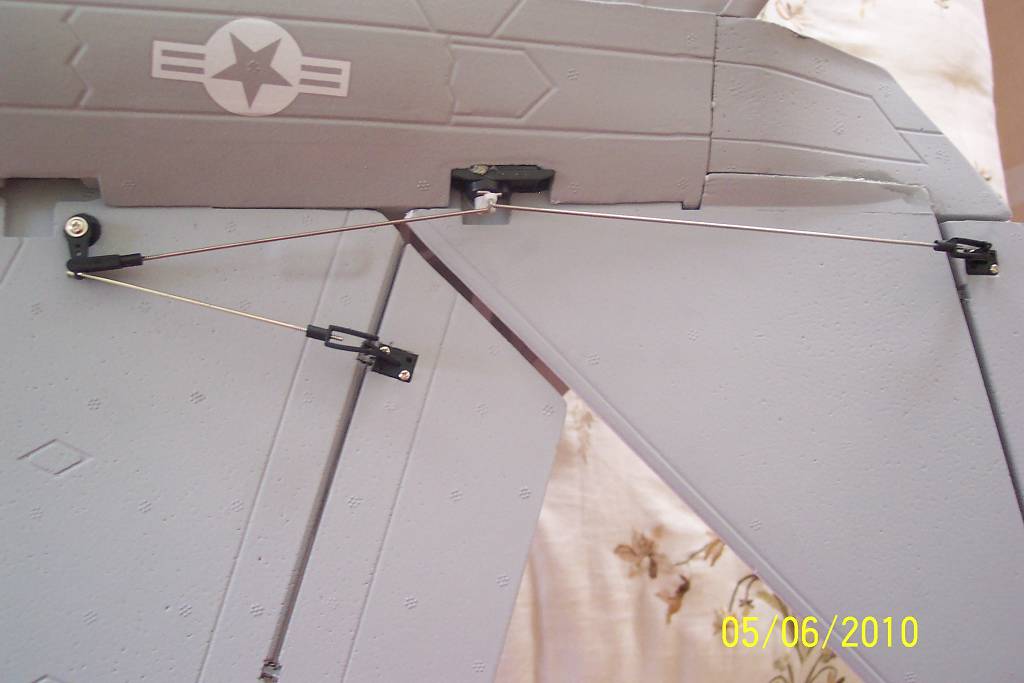

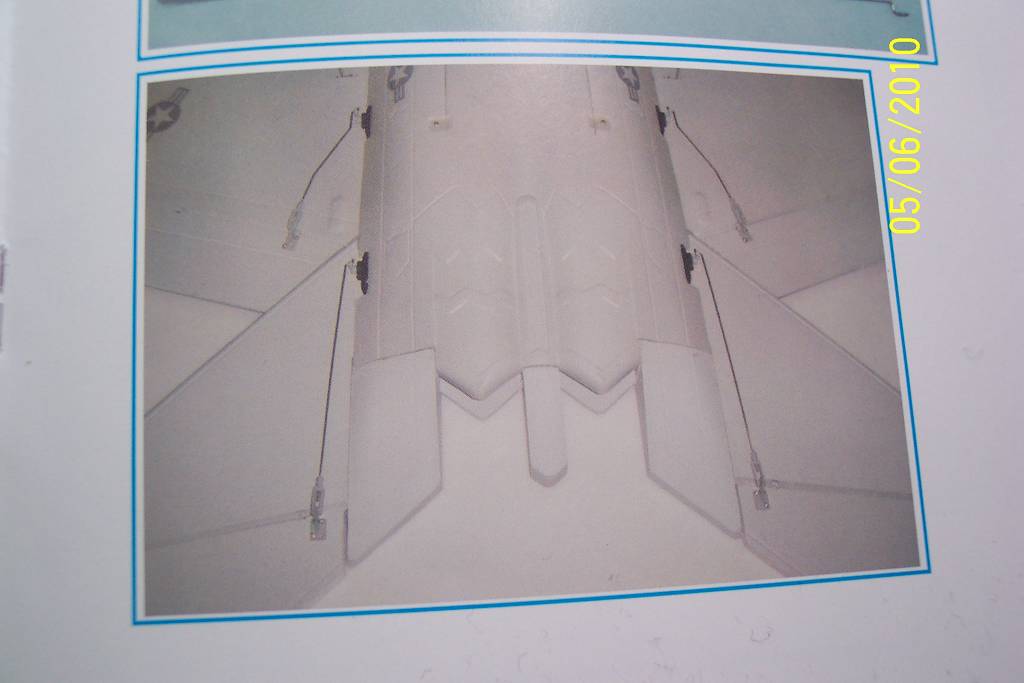

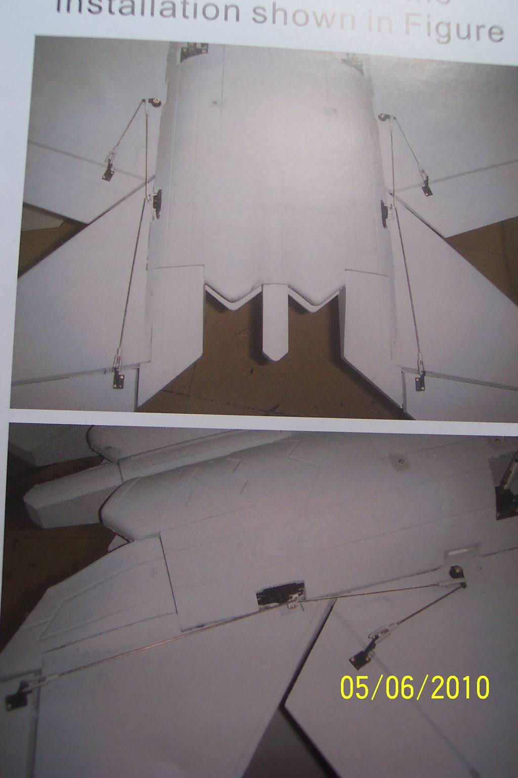

Hey everyone. Ibought a EDF jet, It's an X22 design. Idid research before getting into this but Ithink Imissed something. Most planes I've seen, have a set of servos controlling the ailerons, to "tilt" the plane side to side....then a set, or single, servo, to control the elevator(s) to tilt the plane "up and down"....my plane has no rudder, so if I want to turn it, I would "tilt" it sideways using the ailerons, then pull up using the elevators, and it will turn...correct? Ithought this is how most planes without rudders work....so when Igot my plane, Inoticed that the manual is showing what Ijust described, one servo for each aileron and one for each elevator....but the plane only has two servos total...one on each side. I then found a little cheap pamphlet showing me that Ineed to LINK together the right aileron to the right elevator and same for the left.....how is this going to work? The planes wiring came pre labeled for installation into the Rx and there is one wire "aileron" and one wire "elevator"....but now the pamplet is telling me to link those servos together?..this is a 5 channel plane (throttle, retracts, nose wheel, ailerons, elevators), but since I'm being told the link this, it's becoming a 4 channel now? I'm just not fully understanding how this will work when I want to tilt the plane to turn, it's also going to want to go up or down....and when I want to climb, both the ailerons and elevators will be moving.....not sure if that's "normal"?....the parts package didn't even come with any linkage to install the extra servos, just linkage to link everything together.
Just confused, and looking for some insight.
Itook some pictures since they are better at explaining than me, I took one of the manual showing the one method with dual servos, then the pamphlet showing the linked way Ihad to do, one of how I set it up according to the pamphlet, and one of the Rx showing both the aileron and elevator wires.....
Thanks for reading.

Well, this is sort of a cheap way to make both elevator and ailerons called elevons.. elevator-ailerons. Cheap in that it uses two servos instead of three or four.
Some, if not most, flying wings use this principal, where they use two servos, one on each wing, controlling the aileron for banks and at the same time, the same control surface as elevators for climb and descent. If you notice the arrangement with the bellcrank in between the servo and the aileron, it will pull the aileron down at the same time as it pulls the elevator down. This acts to bank the plane if you move the aileron to the opposite side. (aileron, if looking at it from the back, right stick moves the right aileron UP which banks the plane to the right, right wing down, and vice versa for the left side).
With the elevator, pulling on the elevator stick moves the elevator UP to cause the nose to move up, rear to move down.
Now combine these together, using mixing in the transmitter and you will get the same operation, but at the same time but with different stick movement.
Does that help? I hope I didn't confuse you as much as I confused myself when writing it..

"my plane has no rudder"
I assume it DOES have a rudder or a pair of rudders, but there is no control surface on the rudder, nor servo right?
Your plane basically uses Elevon mixing.
Both the ailerons and elevator move in unison on each side.
This is often done on inexpensive ( cough *cheap!* cough ) foamies...
Normally the plane is set up so there is more elevator travel than aileron travel per side.
This lets it pitch up and down without killing lift altogether.
While a bit strange looking, the plane will probably fly just fine.
I have a foamy Mig-29 that is set up just like this... It has two rudders, but no control surfaces nor servos for the rudders.
The Ailerons are linked back to the elevators.
The plane flies surprisingly well, and will even perform nice nose high landings.

You could probably install your own separate elevator servos.
I did this with a similiar plane that came with that elevon setup...
I used Spektrum programmable digital micro servos, and I used a programmer to reverse one.
This worked great.
This worked great.

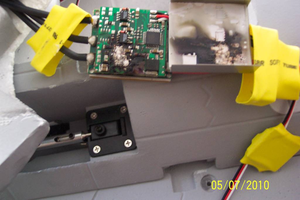

So, just in checking out the jet, I charged the battery, plugged it in, got the beeps, hit the throttle a little bit, the fan went on, then stopped, and the ESC started smoking, and the motor stopped working. Great first start...guess I'm going to contact Banana Hobby tomorrow

Yea, I also found right before the ESC went, that the retract servos are stripped and don't fully extend/retract the gear....so far I'm very upset, Iknow $250 isn't much at all when it comes to this hobby, but to have a defective MAJOR part (ESC) and THREE defective servos on a "bonus" option (retracts)...I would expect more from $250....
I contacted BH and they had me send a picture of the ESC, which I'll attach here also. They got the picture and then told me Ihad to send it in for inspection before they will send out a replacement, and that they would send me two replacement servos for the retracts (even though there are three), and then even straight up told me Ishould rather just invest in some "quality" servos for the retracts.....I don't understand why they would pretty much admit that a product they sell has inferior parts, but oh well. Iremember reading a story of someone on here who had the same ESC problem with the same model as me, and he said as soon as he let them know about it they had a new one at his door in two days, so I'm not sure why I'm being asked to send this one in for "inspection" first, doesn't the picture say enough?
