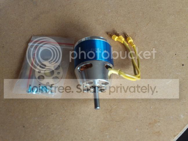

<span style="font-size: medium">HYPERION Z3019-12T, "900Kv"
</span>
I have JUST made 1 or 2 of the first test runs on the HYPERION Z3019-12Tmotor. Hyperion quote a Kv of900 for this motor -whereas all the other 12T motors with 3020stator have a Kv near 1000.
Well -guess what ? For the first runs, PeakEff gives a Kv of 1008, and DriveCalc givs a Kv of 1014 ....!
It is <span style="font-size: small"><u>NOT</u></span> a 900Kv motor -it is 1000Kv, like all the others .....!
More on thismotor test , in next few days ...

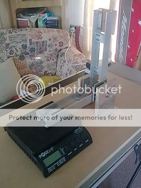

About Test bench in pictures.
I think it can not get absolute value testing, sure.
BUT,
with the some test machinery , in the some place and in the some situation, changing only motor.
You'll sure have one relative safe and precise comparative value.
So,
you can seed this is motor is better that that motor
( on that test motor stand, on that place , on on that temperature situation ).
That's not so bud![8D]

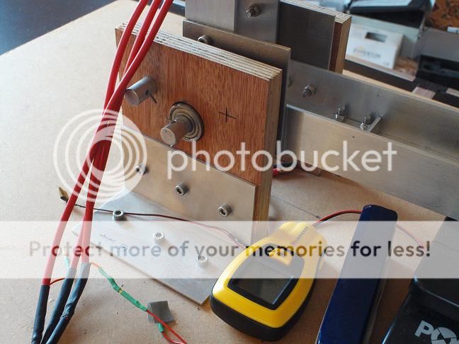

ORIGINAL: Propworn No bearings or counterweight to eliminate or reduce friction for crying out loud
</span>
</span>As you see from below,<span style="font-size: medium"> BEARINGS <u>ARE</u> USED ...</span>-They are 1/2in inner diam, 1-1/8in outer diam; Japanese high quality KLNJ</p>
I actually thought very carefully indeed about this Motor Test Stand design,and designed and built it over severalmonths -Also with the advice and input of Dr Kiwi, who has been testing brushless motors since 2004, and who has published probably well over 100 brushless motor tests -see: http://www.geocities.ws/dr.kiwitn/</p>
<span style="font-size: medium">So Propworn, we have tackled the first thing you mentioned-bearings. And we have shown they are of course used in the MotorTestStand...
