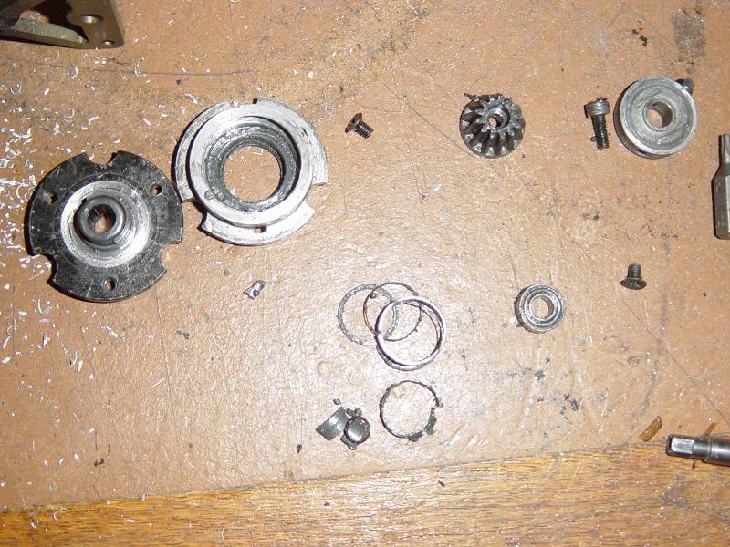

well, the sooner i get a 1/8 centre diff in the .28 the better - i just wrecked the 2 speed for the 4th time... its too much for the cam type hub i reckon, it really slams into 2nd gear, and over time either the cam snaps or the pin it locates onto will fly out or snap. not sure whats gone this time, its jammed in both 1st and 2nd gear at the mo, spurs are solid but not straight, and the hub has moved forward on the shaft somehow...
absolutely no spare cash due to xmas/job change/new car etc etc, so its just gonna have to make do with a regular single speed for now.
i had to retune it a fair bit today from the snowy carb settings, took a while... turned out it was too rich on the lsn by quite a lot... once adjusted, i found a whole new load of power that i havent had out of it before (probs what killed the 2 speed so quickly) very hard not to flip it now whenever it gains traction for a second, so even more reason for the centre diff.

cheers mate, but if its that good - why cant i stop it from breakin stuff?!?!? lol
turns out it was the bearing in the 2nd gear hub that collapsed/disintegrated... again. the hub is about to lose its pin for engaging 2nd too, and they arent cheap! bugger.
diffs are still fine - im impressed too, didnt expect this kind of life from em - hd crown and pinion gears on both, but even so...

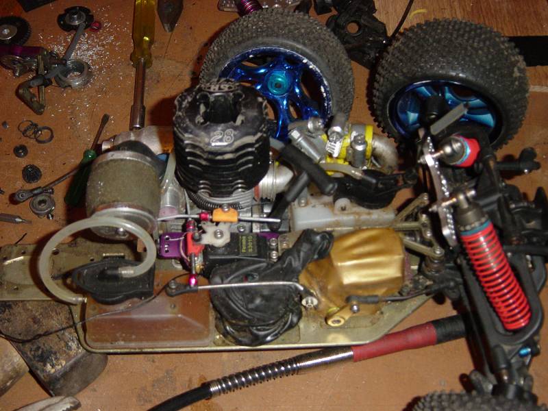

UPDATE! (woohoo)
engines running real bad... sometimes got some power, sometimes not... hard hot starting... compression is low... no sleeve or piston sets on ebay.
so what to do? pay retail price from the US for piston and sleeve? could do... but what is the price difference compared to a new motor? hmmm, decisions decisions.
anyone know of a sensibly priced place for SH engine bits by any chance?

I'd say pinch it or pull out the head shims to help regain compression.
If you need to replace it I would recomend the STS .28 it is allot cheaper (70.00uk on Ebay) than the SH and has allot more power.
