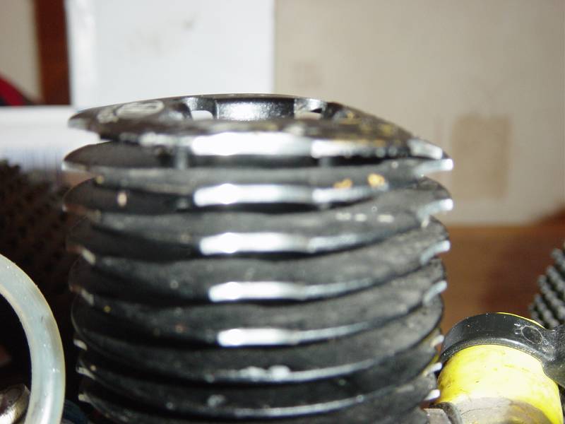

i am now a member of the Snapped Shock Tower and Dented Head Society... many other bits damaged, pipe is a write off etc, i dont wanna look any further for a day or 2... or 3... doh just looked, sand in the carb, and the filter came off, and yes the engine was running when it landed. shell was on tho...

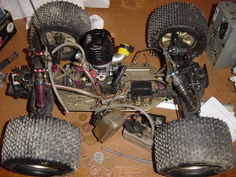

it looks a right mess, but i think its not as bad as i first thought. diffs are ok, chassis looks pretty straight, front tower is bent a bit, cooling head got the worst of it, shell is erm, a basher shell for sure, shocks look ok - and hey - the driveshafts are ok!! suspect both tanks are dead tho - they went about 30 yards, curiously still joined together! pipe is a gonna too. but the big one is the motor... will rip it down and take a look one day. i can only see sand in the initial opening, shone a torch down the throat but cant see anything in there.
tell u what tho, running 3 savages and my lil beasty outside a pub gets a big crowd, well, 40-50 people, and hearin them say "look at that gold one go!" is a pretty satisfying feeling. hearing them go "AWWWWW!!! that looks expensive!!!" feels like ****
lol, gutted or what...

All in all it doesn't look to bad. If the engine is ok put the thing back together and have some more fun. The pipe doesn't even look as bad as you made it sound. You can put that in the freezer full of water and capped off and alot of the dents will come out.
You can also use the stock shock tower.
Try using a throttle return spring as well as a fail safe. It will kind of act as a backup to the fail safe.

Dude, the engine will be fine if the crank case is undamaged. The pipe has just been given a bit of 'character' and as rolland says, the stock CEN tower is sitting there just waiting to be bolted on.
If you do need to replace the head, I'm sure good ol' ebay will come to the rescue.
May have to arrange a race against a real Savage though, one with a 'proper' engine in it!!!

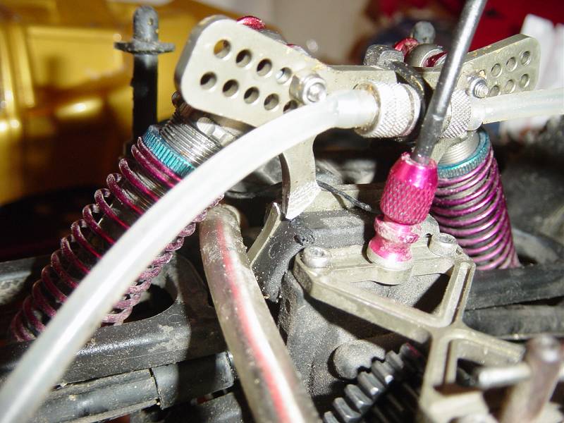

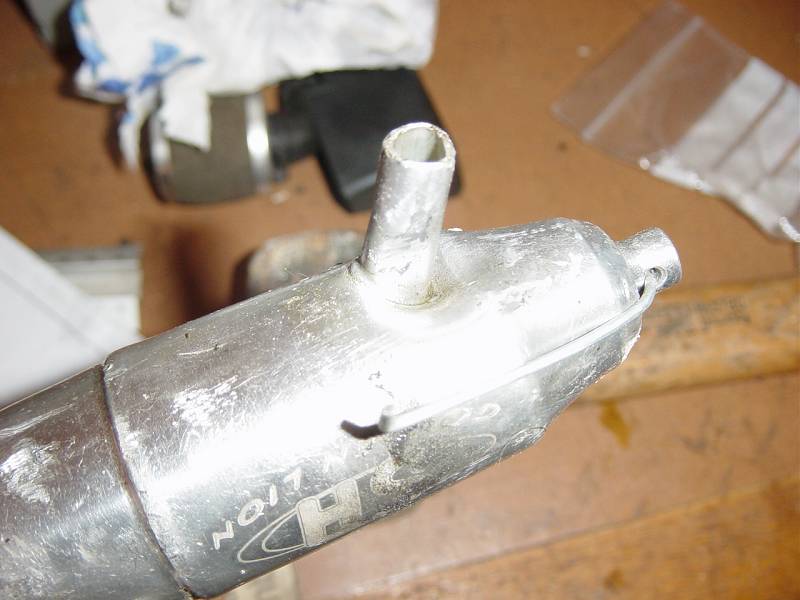

i have had a bash at getting the pipe back as it should be, thats why it doesnt look too bad now, but there are a couple of splits in it around the outlet, that need a fix. will try the freezer technique, if i can plug the splits - thanks for that rolland. also - there is a throttle return spring, i still dont understand the runaway.
azzman - dont make me come over there!
as for the tower, the stock one wont work with my shocks, due to it being shorter, which is a bummer. the jt one is useable, but only for light running.
proper savage? ha! the weight difference was very obvious, just thru throttle response really. out wheelied and outrun by a cen... oh dear. bring on the "proper" savages!! lol.
gotta check that crankcase out...

Try soldering up the splits and cracks in the pipe. If you use a high heat solder there should be no problem with leaks.

and yep, i will be soldering the splits - they are each side of the stinger, nearly all around it, where it was welded in to begin with. its the side that points downwards, so it still looks fine on the truck at least!

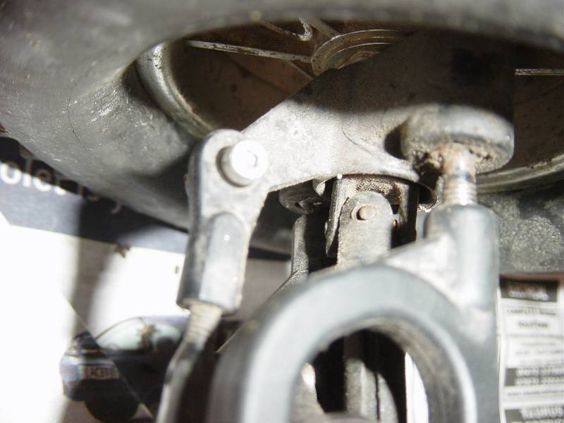

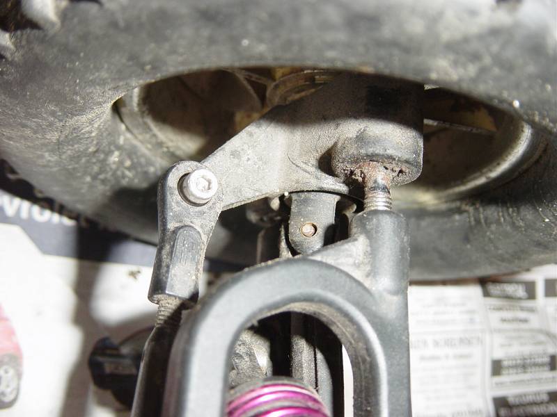

had it in bits last night, various screws are stripped all over the truck from the crash, some got pulled out completely. one driveshaft is twisted thru 90 degrees, but still seems solid. only other thing is the rear outboard cvds, as they are plastic, the pins in them are starting to stretch their holes somewhat. the rears are second hand tho, and they have held up for a gallon or so thru both the .18 and the .28. maybe time to buy another pair - oh no! a whole £5 for driveshafts? lol - lovin it!
