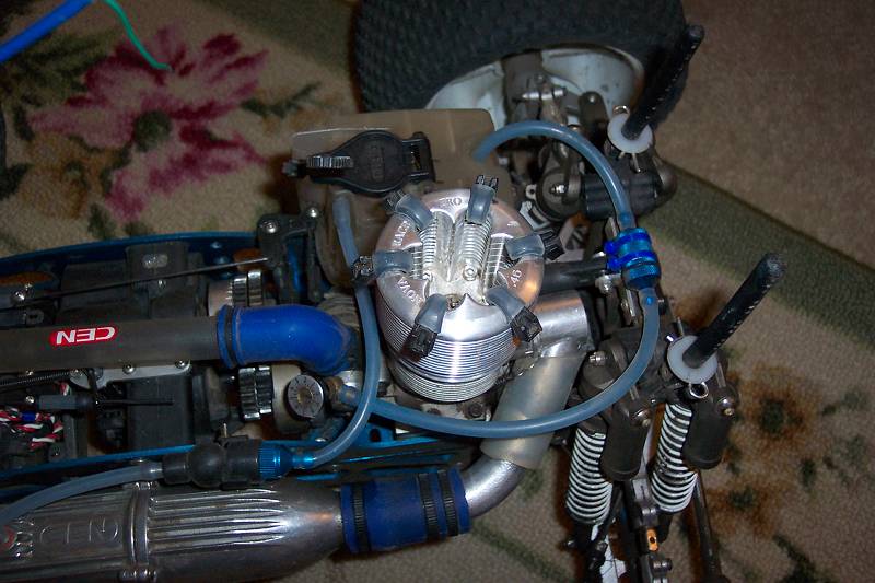

Hello,
Few weeks ago i purchased a GST 7.7. I ran three tanks of gas through it and then started playing around with it in my parking lot. At first, i was having a hard time getting the truck to move. With the controller in hand i could hammer it down and the truck would rev up like it was going to move and it would move... just about three inches... and stop. So, i started leaning it out thinking that it might be getting too much fuel and it seemed to be helping. However, tonight i got out again and start playing with the truck and it is doing the same thing. I can hammer it and it will rev up and stop. What is causing this? I need help!! Where do i look/start??
Also, the breaks are somewhat stopping the truck now, but not what i would expect. I expect the truck to do a nose dive when i apply the breaks, this isn't happening. When applying the breaks, the truck will stop, but by no means is it immediate.

hey Magikman, Welcome to the forum and welcome to CEN Genesis Series ownership. This is a common question, first I 'll ask if you checked ALL of your screws to be sure they were ALL tight?? Then check your set screws on the drive inputs into the front and rear differentials, They are most likely loose or not tightened up on the flat portion of the pinion shaft. Just take out the set screw, put just a dab of blue or red locktite on the screws threads, line up the hole on the flat and reinsert the set screw and tighten as tight as you can get it. Do this on both inputs and you should be good to go...
And as far as the brakes go. You need to adjust them and the radio to push better and harder on the brake cam lever. You could even do endos when the brakes are set properly so be careful not to adjust too much stopping into it.

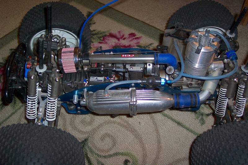

I went out last night to try and tune my truck and get it running like it is supposed to. After playing around with different settings for a while, i came to the conclusion that no matter what setting i set my truck on, none of them fixed the problem that i was having. So, i started looking at other options. After playing around for a min. i placed the truck up on my leg and hammered the throttle and as usual it started out and died. After this, i reached down, grabbed the servo linkage and started opening the throttle manually and what i noticed is that it didn't die out. So, i come home and look to see how far the carb is being opened when the throttle (from the radio) is "hammered" and it is open completely, perhaps even a little past the carb wall. So, this brings me to my questions:
1) How far should the carb be opening when it is at full throttle?
2) Can someone take a picture of their carb at full throttle and send me that picture or post it here?

Hey M4gik, Sorry about the delay in response time. I have been very busy. On full throttle, your carb should only be as open as the throat of the carb, in other words when you look down the carb and fully pull the trigger(the truck power switch should be on but the engine off) the slider should only clear the opening, no further. if it does go further then adjust your EPA on the transmitter so that it does not open any further. Be very sure when you let off of the trigger the carb slides fully closed. If you think pictures will help, I can post a couple for you..
Good Luck and Most of All Have Fun!!
