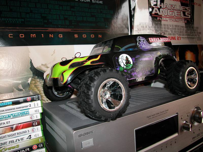

To add to this question. I have a FF ST2, wanna try putting larger Monster truck tyres on it, my LHS says I can just swap them straight over and some people say I have to make some mods to the truck! Which is true?

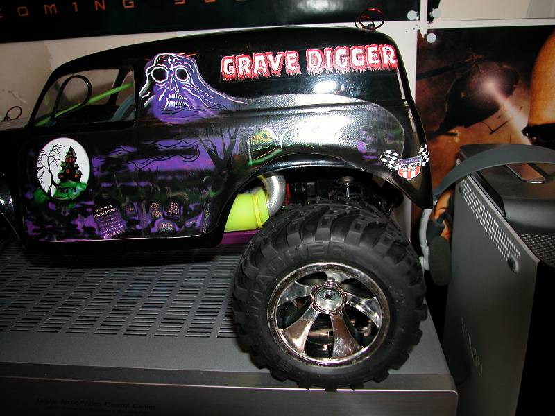

I decided to go with the above chosen wheels and rims! As, i've already got the 17mm hum attached from previous street wheels!
Damn shop sent me the four rims but only two tyres (asap in the post apparently???) Never mind, this is how they turned out, any good???

You do not want to use paddle tires on the front they will add to much stress to the steering system and it will not steer or handle very well.
If you want to use something other than ribbed tires on the front try to find an MT wheel that is the same diameter as the paddles.
As for wheels you need to use a 2.2 wheel with as little offset/backspacing as possible such as rear Nitro Stampede wheels or HPI Nitro ST2.
If you search for wheels in this forum you will find lots of info. The same goes for tires.
