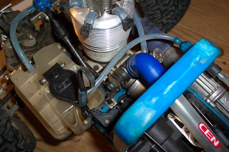

One thing you will want to keep in mind is the heat of the plug, if you get one that is not comparable to the os#8 you will have problems starting and keeping it running... You will have to break in that engine since it has new piston and sleeve, it is now a new engine again
Here are some pics of my needles
ID:	750076   Click image for larger version

I wonder why my HSN is so far out with the primer pump installed just to run 240
Old 08-26-2007 | 01:31 PM
  #32
The Real Dogman's Avatar
Joined: May 2006
Posts: 2,256
From: Pontiac, MI
Default RE: Help Me!
Could be your climate, remember, I'm at 2600 feet above sea level and hot!! thin air...

alright, with giving it a little throttle i can get it started, but it wont idle, i have to keep my finger on the throttle just abit to keep it running, i have my hsn at 3.5-4 and my idle is pretty high. what should i do?
Old 08-26-2007 | 02:50 PM
  #36
Joined: Feb 2006
Posts: 844
From: WARWICK, RI
ORIGINAL: DarkFire989
You are using the wrong type of plug...Bigger engines require a medium to cold plug while smaller engines need a hotter plug. The OS#8 is a medium plug..your ploblem could be from using the wrong plug.

Ah really?[] I just bought that plug. Is it possible that the fact that the fuel line running from the exhaust to the tank is a foot long( i had no other fuel lines so i took it off the revo.
but the os8 and a3 are hot/medium plugs [link]http://www2.towerhobbies.com/cgi-bin/WTI0091P?&P=SM&C=GME&V=OSM[/link]
It could be...trim it to the proper length and see what happenes...I still think you need to get rid of the traxxas plug....using the wrong type of plug can cause overheating. Get a OS#8

Yeah with an OS#08 you know its the right temp plug. Sorry you just went and got it, but..be patient.. Order more than 1 for later
The pressure line should not affect the idle as much as the plug and your low speed mixture. But the Pressure lne should only be as long as you need to get to the tank.
When you took out the valve did you reset all needles to factory settings??
