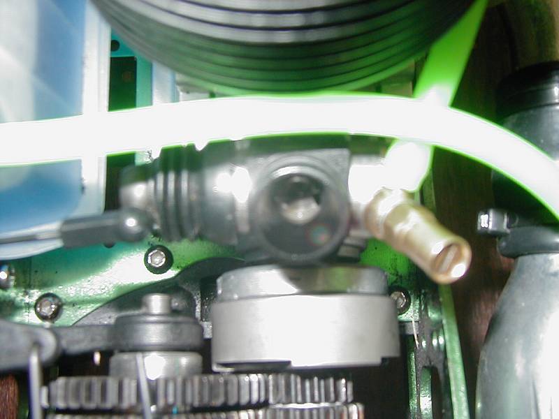

Here are some pics of my needles. I know the pics arnt to great. 1.3 mega pixel camera.... But will my traxxas plug work with my truck?
Edit: Woah! WTH? I dont remeber them being taken like that. I need to fix them.
Old 08-26-2007 | 12:34 PM
burningpoo's Avatar
Joined: May 2007
Posts: 631
From: easton, PA
Default RE: Help Me!
The only thing I can make out is that your HSN is below flush. U gota hold still for a few sec when you use a digital camra or it get's a poor quality. I hate to ask, but, can U take more pic's. Try leaning against something to steady your hand so it can come out clear
Is the traxxas plug a #8? EDIT: some plugs have a extra space or ring or some crap that is for compresion i beleave. U can't use that one
Old 08-26-2007 | 12:42 PM
The Real Dogman's Avatar
Joined: May 2006
Posts: 2,256
From: Pontiac, MI
Darkfire, I see your problem!!! Take out the Checkvalve, Breakin your new engine, once its running well, then put the Valve back in and retune for the valve. I would say try to turn your needles in untill it starts and stays running, but I think getting it started is more important right now!!!

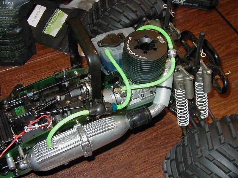

But I really dont know if the engine is new? I think they just rebuilt it because there are scratches from when I had it before i sent it to them.
ID:	750055   Click image for larger version
ID:	750056   Click image for larger version
ID:	750057   Click image for larger version
Old 08-26-2007 | 12:51 PM
Joined: May 2006
Posts: 2,256
From: Pontiac, MI
if your piston and sleeve were replaced then its new and needs to be broke in again
Pull the head off the see if the sleeve and piston are new

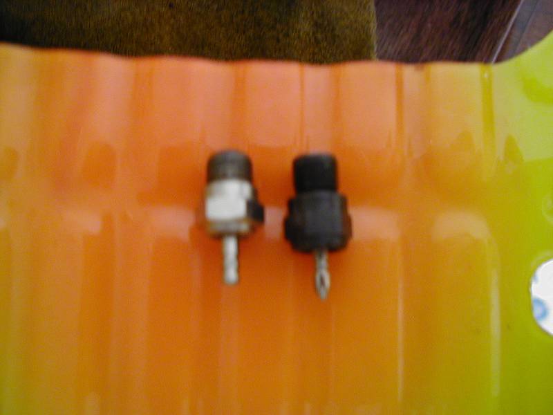

Yeah the piston and sleeve are new... Sigh, but i dont have a glow plug now[] so i cant use that black one in the pic.
This is the black one[link]http://www2.towerhobbies.com/cgi-bin/wti0001p?&I=LXJL33&P=ML[/link]
Old 08-26-2007 | 12:59 PM
burningpoo's Avatar
Joined: May 2007
Posts: 631
From: easton, PA
I think the black one will hit your piston, looks to long.
