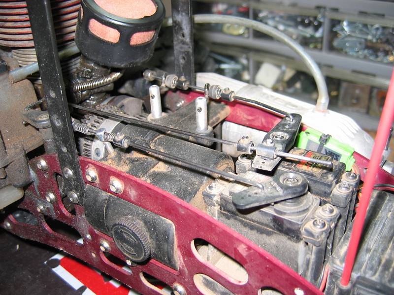

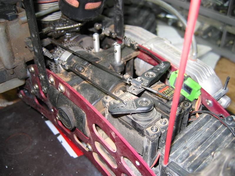

I started to run the first tank today driving it around. And you were right eplummer, when i hit the brakes the engine turns off. In order to get it started the throttle trim has to be set at 20+. So I guess according to you the settings are not right. What should I do with the idle screw. Im currently running 20 % cause thats all the LHS had in stock, I believe the hsn is around 3.5-4 turns out and the lsn is around 1 turn out. How should the idle be, should i turn the idle in more to lower the throttle trim? Thanks for the help in advance.

Darkfire, you need to set the trim so the throttle closes all the way or the throttle servo linkage no longer has any force on the Carb Slider. Once you have determined that the servo is no longer controlling the slider you will turn the idle screw in until it holds the slider open and holds the desired idle RPM..

I have found that setting the idle is a balancing act that may require you to adjust the position of the throttle servo horn (by pulling it off and replacing it at a different angle on the splines), the linkage clamps (with the set screws), the transmitter throttle adjustment, the carb's idle screw, and the brakes (since they are all interconnected). I would set the transmitter to the neutral trim adjustment, and then adjust the carb's idle screw so the engine will idle, and when you put on the brakes, the throttle linkage doesn't push the carb's slider closed (I'm not sure if it is called a slider, but it is the "butterfly" on the other type of carb mechanism). It is hard to explain, but once it is set, it should just require minimal tweaking every now and then. One change I made that helped me with this adjustment was to put a return spring on the carb (connects the slider lever to a fixed point on the other side of the carb) and remove the spring assembly on the back side of the throttle servo horn. This somewhat isolated the brakes from the throttle. I can post a pic if you think it would help. BTW, 20% is a good everyday fuel.

pics would be good. I cant work on it now because the servo battery is charging.

Default RE: Help Me!
Here are a couple pics of my dirty truck:
ID:	760759   Click image for larger version

I know, I haven't cleaned it for awhile, but it is due for a tear down to replace a worn center diff cup and to add some heavy diff lube, and I'll clean it up then. I have a fuel or exhaust leak somewhere around the carb because it is getting heavily gunked up there. It hasn't affected the performance though, so I haven't tracked it down.
