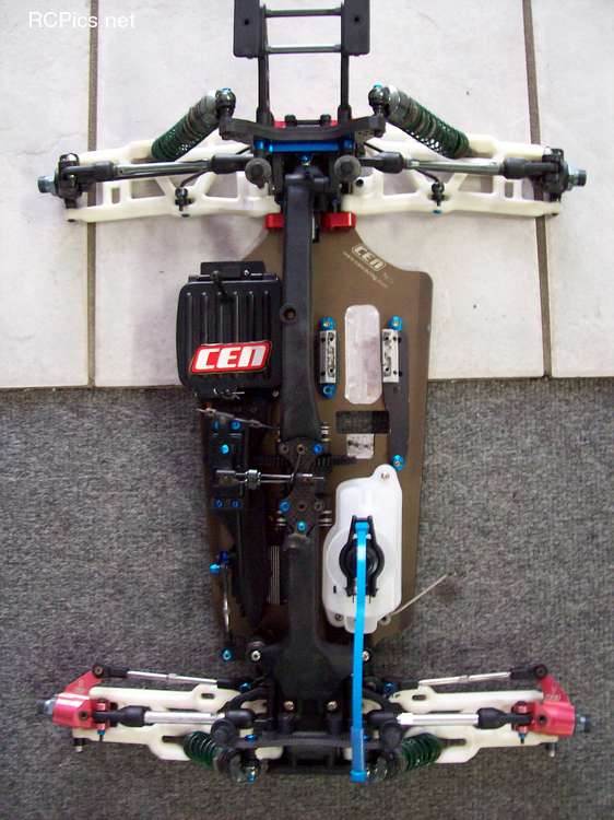

im blown away... i like my cen less now, thanks!! i own the most expensive truck you sell that doesnt even come with wheels or a lid and thats the treatment i get when asking some questions?
unbelievable... you werent getting flamed, just asked serious questions about your product and rumors about parts support. in 25+ years in this hobby ive never seen such treatment? its your job to talk to people who buy your stuff, you represent a company that many people spend theyre hard earned money on. you started a thread asking?
but instead of answering questions or being tactful you just say "welcome to the hobby"?!!!!!
i know the arms are being worked on, i even have an attached pic!! but you cant even acknowledge theyre existence? its been many months since i saw this... using white un dyed arms on the gene the machine's ride.

This past weekend was a sad sight for sure. I remember him saying something about selling out and getting out of RC all together over some CEN issues. I have never seen revoPQRS ever say anything to the effect of getting out of the hobby. He was one frustrated guy. [

ya... it turns like a dump truck on our track compared to a mugen or hyper st. i gotta do something, i was really pissed at my cen this weekend! if i continue to run it ill need to get some on power steering, running rear biased brakes just to whip it around the corners isnt cutting it. i fear im slow compared to what im running against these days!

5-7-1 with cross pins on a dry slick track. the front end pushes too much on power....3t-2s rear plate. i pretty much copied a set up sheet for those conditions. its the truck... i built a hyper st pro and right out of the box with no tweaking and its a mad man on our track!! drove a mugen a bit yeasterday and it had way more on power steering too. so im pretty much at a disadvantage every weekend, because im running against those trucks... our new track layout is all wrong for the matrix. i used to be fast around the old track with lots of berms, but flat, slick turns get the better of my cen.
ill mess with the set up as bit more, but i need to stop driving trucks that handle better than mine! im sure my laps were faster running someone elses truggy and that just aint right...
i wonder... ya know cen is working on a new arena, they have to be, we know about the new buggy. hopefully cen doesnt leave the present owners out of the loop? ill keep my fingers crossed that the current model will be update-able?
i will have a truggy soon that doesnt push in the turns... one way or another!

Hey guys! Here at CEN Racing we have a few different employees monitor and answer questions online throughout the day. So you may notice different personalities when being responded to by "CEN Racing".
The comment "Welcome to the hobby" was taken out of context and meant nothing more that actually wecloming Wriff Wraff to the hobby. If you read two posts earlier Wriff Wraff stated, and I QUOTE: "I'm new to the hobby, so i have lot's to learn and i'm learning alot."
Aside from that: We are listening to you, the consumer and we appreciate your concerns. We are always improving our products to better suit our consumers. We do have new arms for the truggy that will be available soon. I will try to get "actual" dates for you guys. This will be a running change, which means the part # will be the same. Sometimes with running changes we get the new parts un-announced here at our US office. This explains why providing dates can be difficult. However I will see what I can do, with my contacts over seas.
We take pride in offering some of the best online support and customer service in the industry. Not many companies have actual representatives / employees from their office answering forum questions daily.
Revopqrs: There are many ways to achieve on power steering. Through caster changes, differential changes, ride height, tires and more. Wriff Wraff's last post was very informative and I would recommend trying some of his recommendations.
Your differential set up is on the thin side for a Truggy. (When you differentials are too thin, they "diff" much easier. The more your differentials - differentiate the less traction you will experience.) It makes complete sense that you would have no on power steering with that diff set up.
I use the following set up on my truggy and you may want to try it out.
Differentials:
Front: 10k
Center: 30k
Rear: 5k
Shocks:
Front: #1 pistons w/ 600wt oil
Rear: #1 pistons w/ 400wt oil
Ride Height:
Front: Dog bones level
Rear: Dog bones just above level
Toe in: 2t 2s But if you are too loose then put the 3t 2s block on.
ZERO OFFSET WHEELS
Caster: 19 degree - more high speed steering
Give it a try before you sell your truggy Revo. You may be surprised.

well thanks dude.. i appreciate your response greatly! ill try running thicker diffs and see how i like it... i do like the cen alot, i dont plan to give up yet.
